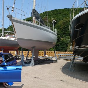

I bought one of these, the 5m tower, for a Moody 41. I have cut and polished, painted the lines top and bottom a couple of times with a ladder and a) it's a looong way down (or at least feels like it) and b) it's a long way up and down when you can only do 50cm or so either side of the ladder before moving it and repeating the process. (I also used to secure the ladder at the toe rail).
The scaffolding is a revelation, and makes the job quicker. A 5m one just fits into a 3 series estate with the polisher, crate full of work tools and us two in the front. Takes time to setup when you get there though, and I used it at times (for the boot top) with just the bottom half. It still feels like a long way down but at least you can sit on the top of the tower and do a full two or three metre length at a time.

From the top of the tower I can step up to the deck of the boat or sit on the platform and sand/mask or paint the grey line. With the bottom half of the tower the bottom grey line. The boat is 1.85m from bottom of keel to waterline, plus the cradle and the freeboard. A 5m tower that I bought has a platform height of 2.75m and the 4m only 2m platform height. I think I may have got away with the 4m for working too but would have had to also take my ladder to get on board the boat.
PhillM's point is very apposite. This boat park has a really good surface to keep the platform stable. Noting also the platform supplier does state not to step onto or off the platform from a ladder (or boat...) so I shouldn't have done that. This was also a very pleasant June day with little wind, no sleet/rain or snow and nice temperatures. If you hire one from an onsite provider it may be heavier duty?
When I have previously worked from the ladder the yard has taken more interest in my H&S, but I was tying off to the toerail anyway so was quite safe.
You also need space at the side to get a tower in, and space in the boat park to assemble and raise.
