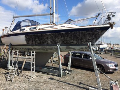

I have one of the Screwfix type platforms. When my Fulmar, which draws 1.6m, is in the yard cradle which is fairly high off the ground, I find I have to set the platform at a level above the maximum to be able to reach the top of my topsides. I should point out you will be working on a relatively narrow platform with no safety rail behind you whilst working.
Personally stranded, unless you are at least 6' 6" and the keel is close to the ground, I feel you will find this model is too low to work comfortably. Either hire a proper scaffold or buy one (which is the cheaper long term solution).
This photo shows the height problem of the high cradle and with the platform one rung higher than it should be.
For those interested, the black spray paint was applied to find some scratches and to see how deeep they are for polishing them out.
