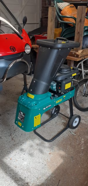

Nick’s Automotive Paint Supplies Ltd in Ipswich, IP1 5AP (01473 745253) makes a great touch up bottle for Volvo Penta Green engines, with a lid touch up brush for us yacht people, at a great price and suitable touch up bottle size = A+++
Good colour match
