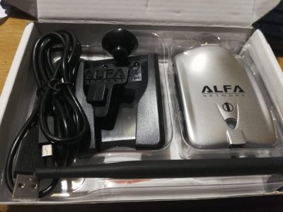

Is an Alfa AWUS036H 802.11 b/g Long Range USB Adapter what the OP needs?
If so, I have one to sell, cheap.
In its box , complete with disc and instructions.
Yes those do help with picking up poor marina Wi-Fi if you have a laptop usb port and better still if stuck out a porthole sometimes. I guess the OP needs a marina signal first though and I’m not certain that’s the issue. I think he wants to create a stand alone boat hub with its own SIM but speculation really at moment.
