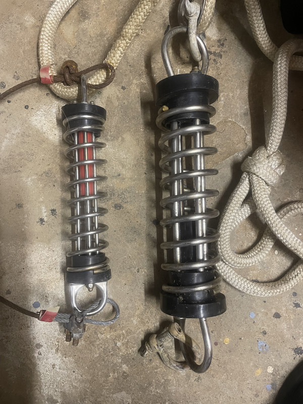

I also broke a nice stainless spring…. I then bought some massively oversized cheap Chinese made spring and it’s been good ever since….just get big springs…and don’t use the rubber ones…after the first storm they stretch into limp useless rubber and never return to shape

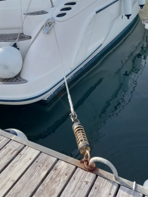

I broke this quite meaty (Italian) spring over the winter in Alghero and it’s only a 37 ft boat. You are right in looking at Osculati because they are anti squeak. Drives me nuts listening to squeaky springs on a stormy night. They do break in ‘safe’ mode though.

The expensive small spring that broke….next to the cheap oversized one that I have used successfully for years….all on a 34 foot high sided vessel subjected to the Mistral
