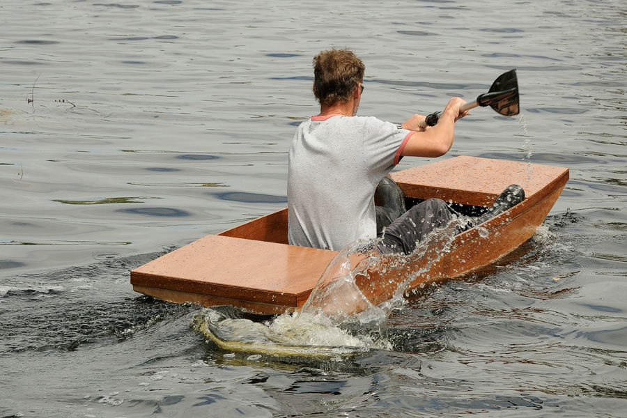

Spirit Eagle
That looks like a very similar design to the Cowes Punt from CB a few years ago.
I built one, my B in law built one, and a friend built 3 for a 'workshop' project for intellectually challenged kids.

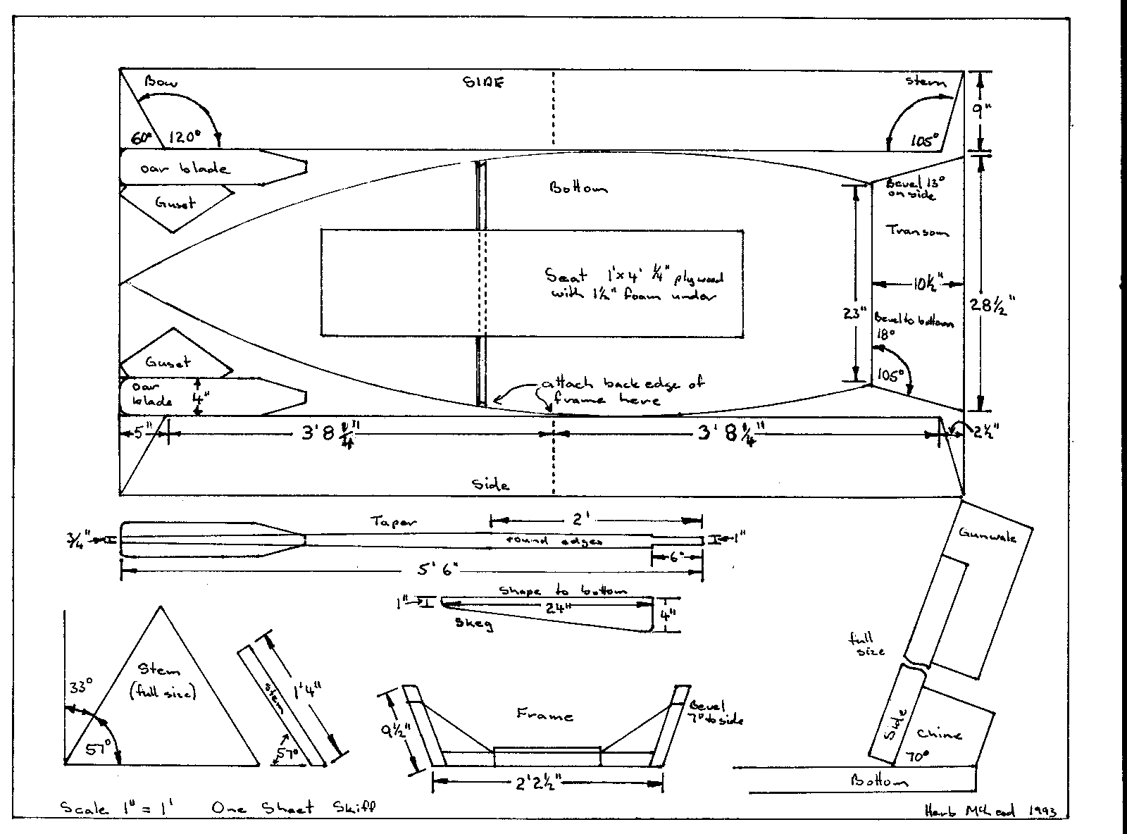

After I built mine, the plans were offered free online by Herb MCLeod, two friends built one for their children. One is called 'Sea Brat'.
I then built three more.
One for a friend and two to be raffled off for the Rotary Club.
One was raffled as "A boatload of coke' and the other as a "boatload of beer'.
As prizes they contained cases of Coca Cola and the Brewery (non-alcoholic products if you wished e.g. Ting) respectively, plus oars, and lifejackets.
The Rotary Club raised over £1,500.00.
