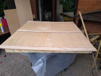

As for using Epoxy rather than polyester, it's mainly because I've used epoxy for several small projects, so I'm familiar with it. I've got to get more epoxy anyway, as I have one more piece of reinforcing to fit before I cover everything. The sides, which will carry the load and, actually be mostly window are 9mm ply, though I think I'm going to double it on the part that will carry the most loading, while the roof is 6mm, with a few 6mm reinforcements. If I was any good at CAD, I'd have a design I could post, but the plan is mostly in my head.
You could post a few photos to show your progress. It may even encourage a few others to follow your example.
