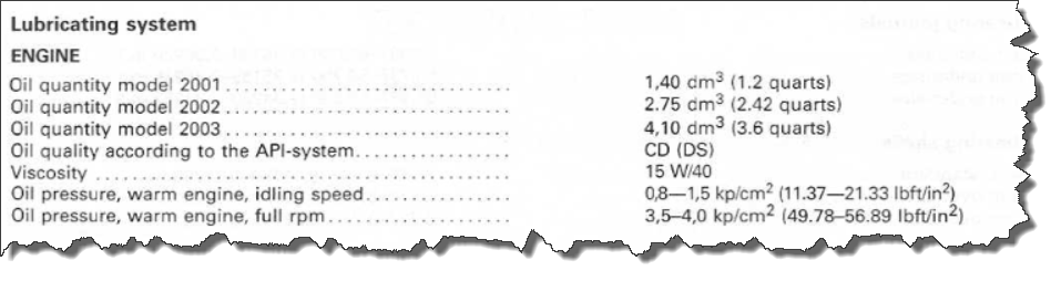

From Volvo's workshop manual
Plain mineral oil 15/40. If buying in supermarket look for the one that is recommended for older diesel engines.
The current equivalent is CF spec. Halfords sell an oil to this spec 15w/40 labeled for "older diesel engines".
if you want to stick to single grade oil I think Morris Oil still sell it.
Lot's of good info, also the above statements. Might also be labelled for Vintage cars.
The API CD standard was introduced in 1955 for severe duty diesel engines, including turbo and Caterpillar Series 3, built before 1995. Equivalent to MIL-L-2104C. Now obsolete.
As the classifications are backwards compatible any diesel-rated engine oil with an API higher (alphabetically) than CD will be fine. Hence also the stated CF.
The viscosity 15W/40 is probably easy to get but isn't very crucial unless you use the engine in extreme temperatures.
