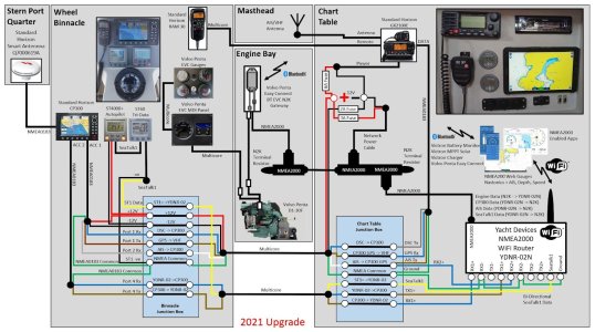

Got all these bits talking to each other on my last boat, a mix of Seatalk, and both NMEAs ... the Raymarine (Seatalk1) autopilot could steer to a waypoint from the Standard Horizon (NMEA0183) plotter ... it worked flawlessly for many years - then I added a WiFi router to make all the info available on all the busses and the Tablet ... apart from a horrible bug - the Seatalk network was overloaded by the default Gateway settings which resulted in erratic behaviour of the autopilot compass and even more erratic behviour of the autopilot itself - I switched off the NMEA200 routing to Seatalk and got it all working superbly.
To connect a plotter to an autopilot do the following ...
First check which plotter interfaces are available and if the autopilot has an equivalent input? Is a gateway needed?
Next check - does the plotter broadcast the necessary sentences on its output? - usually cross track error, heading to waypoint etc. - most do by default as this is a standard use-case.
Then - are the sentences enabled for output? Dependent on plotter but again usually enabled by default.
Wire them together correctly (plotter TX to autopilot RX and connect the common grounds) or simply plug in properly terminated NMEA2000 network connectors - NMEA2000 makes connection so much simpler but some supliers have bespoke connectors and a Brandname - adapters are usually available.
.. and finally, just work out how to operate the autopilot to steer to a waypout - usually you set up the plotter and start navigation to the next waypoint - it then starts broadcasting the info required by the autopilot - then you go to the autopilot and activate it's navigate to waypoint function - they vary as to how you achieve this so read the manual. Hot tip - make sure the boat is heading in roughly the right direction before switching on the autopilot or you could end up with your G&Ts on the cockpit floor.
Many charter companies disable this feature by switching the transmission of the info off in the plotter as they don't trust their clients to operate it correctly.
I did have brain fade at the beginning of a season once, and dismantled the whole system looking for connection problems between the plotter and autopilot, after around 3 hours of tracing connections, I discovered I had mis-remembered how to use the autopilot. Felt like a right tw@t. Put it back together and it worked fine.

Just logged on, saw Baggy's wiring diagram and had a mild panic attack, thought at first it was the Moscow Underground map.. In fact I think the Underground map makes more sense to me..:giggle:
