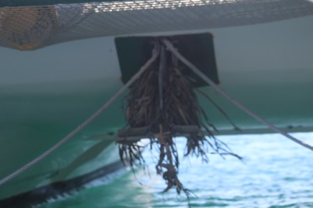

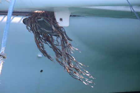

That might work fine in the UK with a nice sandy bottom. Not here. The bottom here is seagrass. Unless you can free drop, you simply drag the anchor along the bottom as you cannot get the chain out as fast as you are going backwards. The anchor clogs with grass such that it won't set.
and this
and if you are lucky and it does set, it will not set deeply enough - and you will not power set, so have no idea.

It’s nothing to do with whether you free drop or not. (I know Geem is addicted to ‘free dropping’ his anchor). It’s simply a matter of not allowing the boat to plough the anchor backwards and snag loads of weed before it’s had a chance to dig in. How you pay the chain out is irrelevant.
