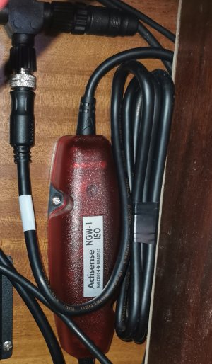

My boat has some nmea 2000 and some nmea 0183.
There is an actisense nmea converter behind the switch panel.
Can I connect another nmea 0183 device? Will the 0183 and 2000 networks communivate via the converter?
Or do i need a converter for each individual device?

The NGW1 blurb says "Multiple NGW-1 units can be used to multiplex numerous NMEA 0183 devices onto the NMEA 2000 network". Only one on each. A YakMUX can gather up 3 inputs and output one 0183 feed into your NGW1. The YakMUX will let you select what strings you would need.

0183 has "talker" ports and "listener" ports.
You can connected one talker port to several listener ports. But a listener can only be connected to one talker.
So if you want to RECEIVE 0183 data in your N2K network from multiple devices, you will need a multiplexer. Something like this: PRO-NDC-1E
You can also buy Multiplexers which have the N2K gateway built in, like this one: PRO-NDC-1E2K
If on the other hand you are trying to receive the N2K datastream into multiple 0183 devices, you don't need the MUX.
