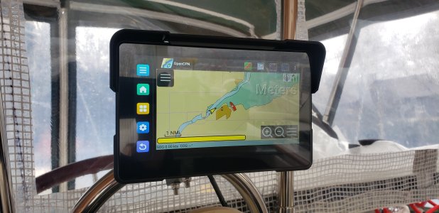

I use the very low cost Open CPN which is far better than anything commercially available.
Seen displayed on a 7" display at the helm fitted for less than £100.

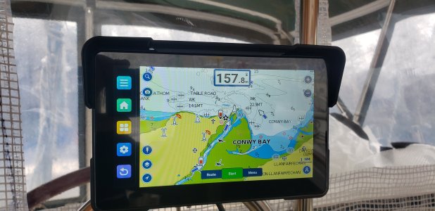

Navionics on lower picture.

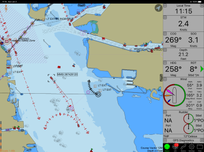

It will be easier on the device's battery if you can consume that data from the boat instruments. As a bonus you also can pull in wind, depth, and other data. Random screenshot below:
