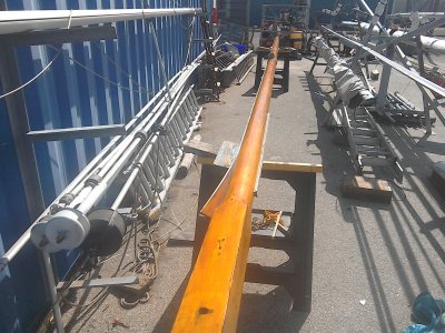

You are on the right lines. with the exception of the white topmast that is exactly what I used on the last mast I did. I had owned it since 1980 and prior about 2003 I used a variety of products mostly traditional and unsatisfactory so I changed to Sikkens Novatec/top which was cosmetically poor but needed only one recoating before I laid the boat up in 2010. The mast was left outdoors in a rack and about 2/3 of the coating was still sound in 2019 when I recommissioned the boat.
Stripped it down (al 34' of lovely Douglas Fir dating from 1963) and use HLS/Filter 7 Photos show the outcome. Don't know how it stood up as I sold the boat, but I used the same on the barge boards of my house the same year and they still look like new.
Photos attached
Good luck with the boat. Very rewarding if you have the time, but the secret with wooden boats is to get them up to scratch and keep on top of maintenance.
