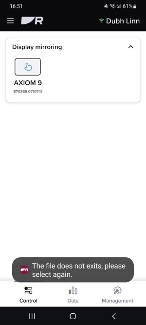

I've finally got to my new to me boat. I've updated the software on both Axoom MFD's. The plotter has a Med &Black Sea Navionics card installed but the subscription has expired. I have the relevant charts on my mobile Navionics app with current subscriptions. I've created routes on the app but when I try to export the gpx file to the Raymarine app I get "this file does not exist" etc as below. Can anyone help a hopeless numpty please.Screenshot_20240422_165120_Raymarine.jpg

I've finally got to my new to me boat. I've updated the software on both Axoom MFD's. The plotter has a Med &Black Sea Navionics card installed but the subscription has expired. I have the relevant charts on my mobile Navionics app with current subscriptions. I've created routes on the app but when I try to export the gpx file to the Raymarine app I get "this file does not exist" etc as below. Can anyone help a hopeless numpty please.View attachment 175837
I’ve just been through this on my new-to-me Axiom… from Navionics app on iPhone… subscription required on both the card and navionics app (someone above mentioned this already I think). Connect to Axioms Wi-Fi, and the app will connect and synch to that, then you need to import the routes from the card… a bit of a faff.. but this video on YouTube steps you through it…

My son, who must have got his technical skills from his mother, arrived last night. This morning, following this youtube video, he transferred routes from Navionics mobile to the expired chart cards on the Axiom 9. The chart card subscription on the plotter is expired more than 5 years so updating online is not possible and we'd need to order a new card. I'm happy enough to keep going with my current mobile subscriptions as long as I can transfer routes etc.
