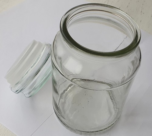

Unless the lid of said glass jar is foil lined (some are, some are not) the solvent can leave through the large lid.
You begin to worry me. The jar is pictured below. About six inches high, with an opening of less than three inches, and a stiff rubber seal around the lid.
Assuming it's not exposed to much temperature variation (and associated uncontainable pressure) is the solvent likely to leach out?

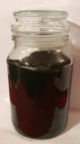

The paint's now in the coffee jar:
It's better than the soft bendy tin, but do I definitely need aluminium tape to stop the solvent escaping, despite the airtight seal?

Do some extra coats and save the space...
I was only using it to touch-up scratches on the Tohatsu.
I could probably disguise all the scratches on all the Tohatsus and Mercury outboards in the country, with what's in the jar.
If I hadn't made the original cock-up of buying black instead of white, it wouldn't have lasted long enough to be a problem.
Still, it'll be good to know for the future. I really hate the way paint tins and their lids lose their circularity.
