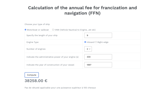

Is there not an annual tax based on the CV ( ie horsepower) of the boat engines for FR registered boats?
EDIT Clarified thanks to westernman. “Applies to all boats owned by French residents Irrespective as to whether the boat is French registered or not, and whether it is kept in France or not. Or has ever been in France or not. Or whether the owner is French or not.”
Yes. On all boats owned by French residents.

The administrative power isn’t the actual HP. There’s a formula to calculate based on no of cylinders, bore and stroke IIRC
Found this, a bit pigeon English but hopefully you will get the idea:
In France, for a boat engine, whether it is a sailboat or a motor boat, the tax calculation method takes into account several parameters: number of cylinders (represented by n), bores in millimeters (a), and stroke in millimeters (c).
The bore is the internal diameter of the piston. The stroke is the piston's travel distance inside the cylinder. They are multiplied by a different constant depending on the engine fuel (diesel or petrol):
fiscal power of a diesel engine = (315 x n x a^2 x c) / 100,000
fiscal power of a petrol engine = (45 x n x a^2 x c) / 10,000

For a diesel engine the fiscal power is almost exactly 4 times the cubic capacity in litres. For boats.
For cars they have changed over to use a formula based on CO2 emissions - it used to be the same system.
So my old Golf TDI 110HP 1.9 litre diesel from 1998 using the old system was 7CV.
The 315 is actually 100 x pi approximated so the poor tax officials can work it out more easily with pencil and paper.
And of course rounded up as everything to do with tax always is.
A 300 HP Volvo is 3.7 litres. So probably 15 CV.
Try using that in the equation instead of 300 CV!
The result will be less of a shock.

That can't be right, surely. Annual tax on my circa £50K 29ft sportscruiser is over E38,000 per year :eek:
I’ve not looked into it massively but 22 is 200hp according to one site. So for my 8.3m with a single engine it’s going to be 800 or 900 euro per year.
