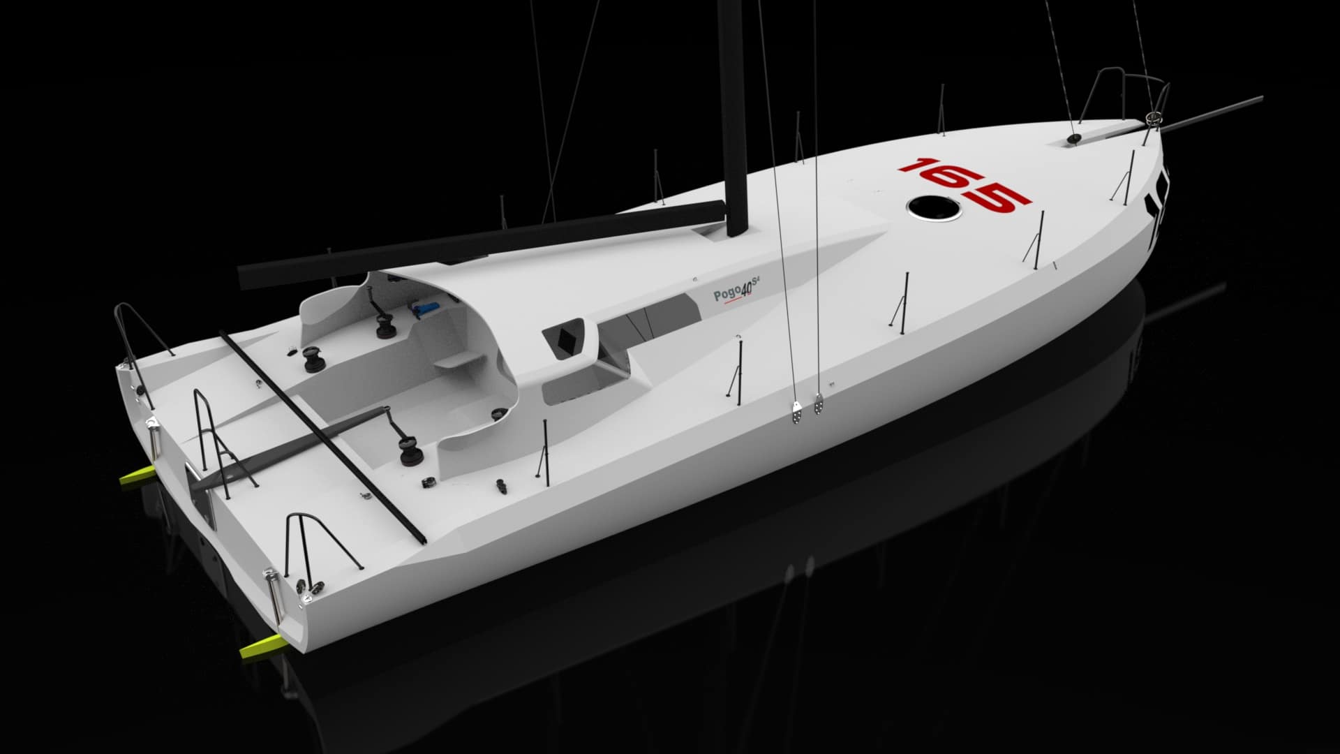

Looks like it might be a canting keel ?
No. It’s a class 40. Fixed keel.
They’ve recovered the hull, so the cause will be known at some point.
This was a brand new boat, but the class 40s have been around for a while, and done some serious mileage including RTW, so it’s not like there isn’t a well proven method of fixing this type of keel already in use. Will be interesting to see if this boat had deviated from the norm in terms of keel fixings.

I'd love to know the make of boat and the mode of failure. Looks like a very clean slot where the keel parted - perhaps it's a lifting keel?
It's an all-out prototype race boat, so presumably a lead torpedo on the end of a long fixed slender strut. Possible brittle fracture or fatigue but I doubt they will be publicising their findings.
