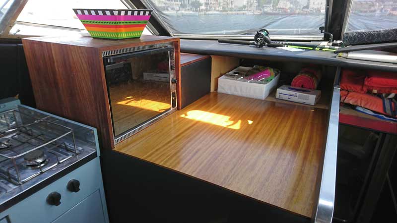

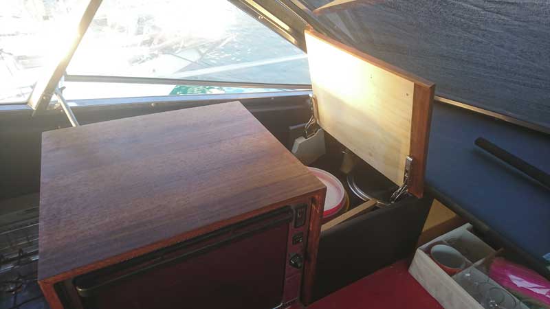

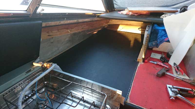

Had to finish off the galley and surrounding area and mainly the storage space which was underutilised. So removed the oven (a chance to find out why it wasn't working...) upholstered the whole are in front of it and under the dash panel all the way to the front under the windshield.
Then I added the "lid" to that opening there using some fancy and quite expensive blum mechanisms that were a pig to setup they way I wanted. They were meant to be for vertical hanging cabinet fascias opening by pulling and lifting up. I used them flat, opening them up and outside clearing the dash horizontal panel and not fouling on the oven cabinet... Worked in the end but must have lost a dozen litres of sweat in the process!
finished article filled up with pans, chopping boards, et al. Note on the port side the slanted side panel didn't allow me to fit the mechanism, so had to built a new L shaped panel, upholster it and bolt it down in order to support the mechanism:
Hidden behind the oven is a double socket for the La Pavoni which should be standing on top of the oven and pulled down to the worktop when in use.
Further, George did a 12mm iroko worktop with tongue and groove diy joints. Relatively easy job to fit, again 5-6 coats of oil and fitting. Haven't secured it yet, need an upside down L shaped piece on the front to hold it down and avoid warping under the extreme heat of the galley.
Still missing a deep drawer in under the dash where the iroko worktop ends and a cabinet door where the old school lifejackets live (temporarily). I want to have plates, glasses and stuff like that in there so got to find decent layout to keep them all apart and from rattling/braking.
Problem is that the drawer I want to built is impossible to hang and have sliding mechanisms for, as all mechanisms expect some space to the sides and or under the drawer when pulled out. I have none unless I do the trick of reducing the width of the drawer and keep a wider fascia panel in front. We shall see.

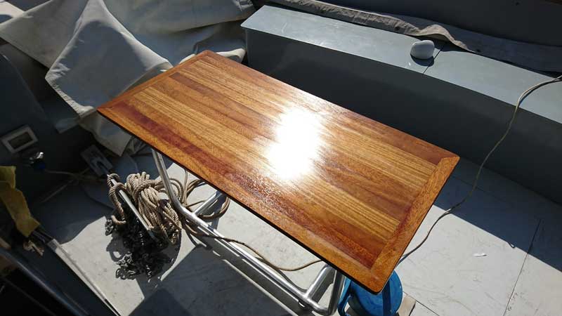

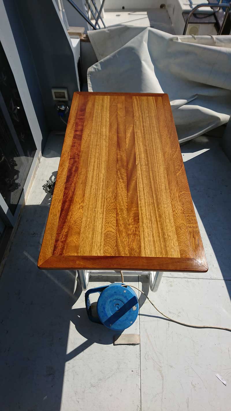

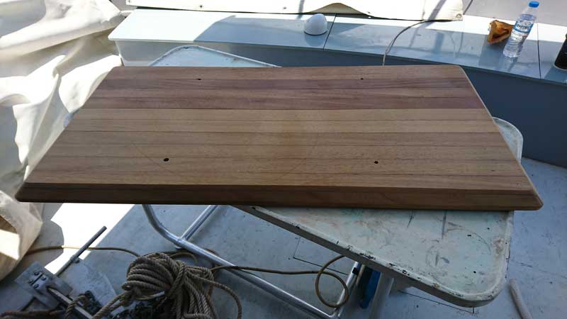

Another project completed was the table top for the original ali framed table. I think I've overdone it here, plinth is 30mm thick with a 12mm ply lined with a 12mm iroko on top and 8mm iroko leftovers underneath, all epoxied and pressed together. Plan was to make sure the thing wont warp as it often happens when you line something on one side...
In between the layers I added the consealed 8mm nuts for the studs that bolt it on the frame:
End result after 6-7coats of a decent quality oil is rather good:
A comment from a friend is that I didn't built side extensions to increase the table width. Indeed didn't like the idea, may do a snap-on piece in the winter although it's good enough for a few of us eating. Not too bothered now.

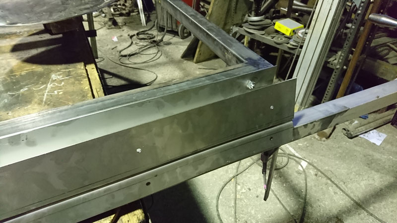

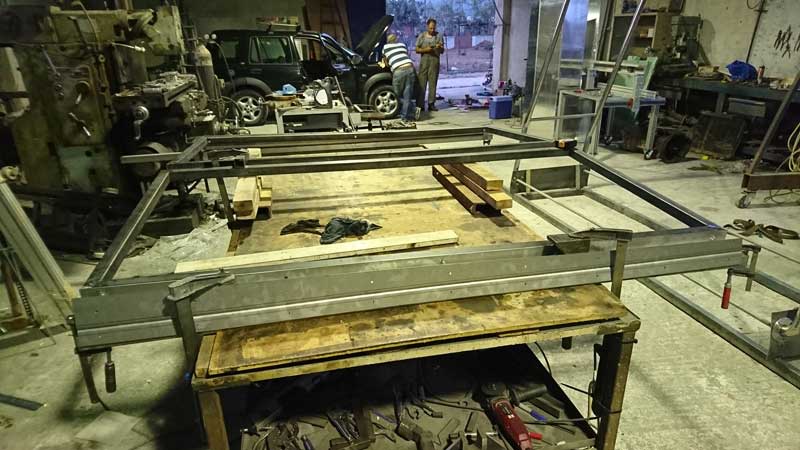

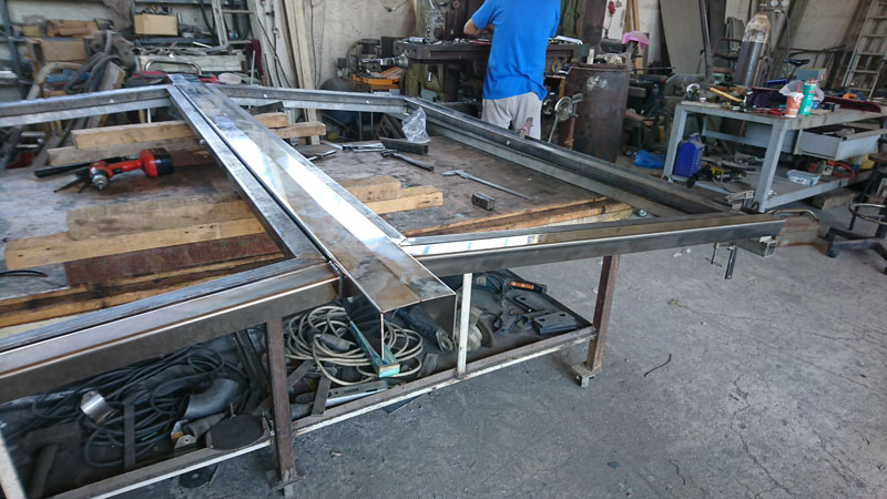

Tomorrow the top frame H/T should be all welded and ready to be welded/bolted onto the 4 pilars.
Hope that by Wed it will be fitted, fingers crossed!

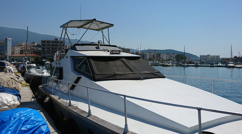

Just back from a full week on board exploring the isles around us, swimming, sleeping and generally relaxing. Not in a mood to work at anything, so I thought I'll update on the H/T which was fitted a few days before leaving.
Remember side elevation was meant to be something like this:
Not far off it, radar base is different and unfortunately I specified it too high imho, and it's not easy to chop it either.

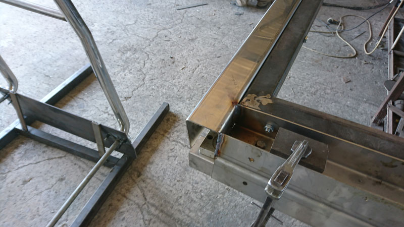

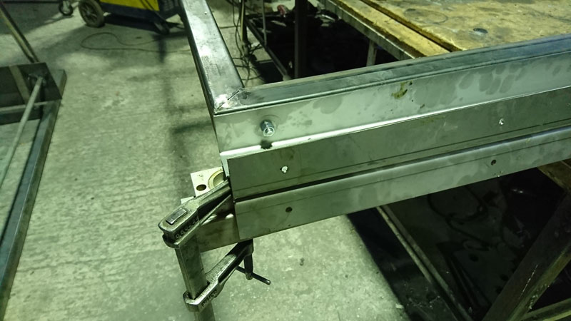

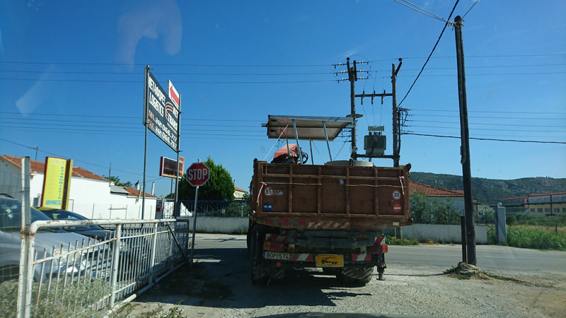

Nikos having already built the mock for the superstructure and fitted the 4X48mm pilars, went into fabricating the top where the two 2X1m panels fit. In order to do so, he made two mocks of the actual solar panels (oversize by 6mm on each side to cater for the UL polywhatever strip that will be fitted between ss frame and ali panel) so that he could weld and built all the construction around them. At this point he also bolted on the side gutters the stronger (5mm thick) L shaped section that the pilars would weld on. Plan is that I can (if I wish) undo 10 M8 bolts and lift the top frame of the pillars.
Worked a treat:
And off it went to the dock by the boatyard to be lifted and fitted:
Unfortunately haven't got any pics when trying to fit the beast, so next pics are with the H/T fitted...
I can say it wasn't an easy job, and would have been 100X easier with the boat on the hard, but couldn't justify the cost having recently paid the diver to clean the hull...

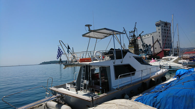

Now to the problems:

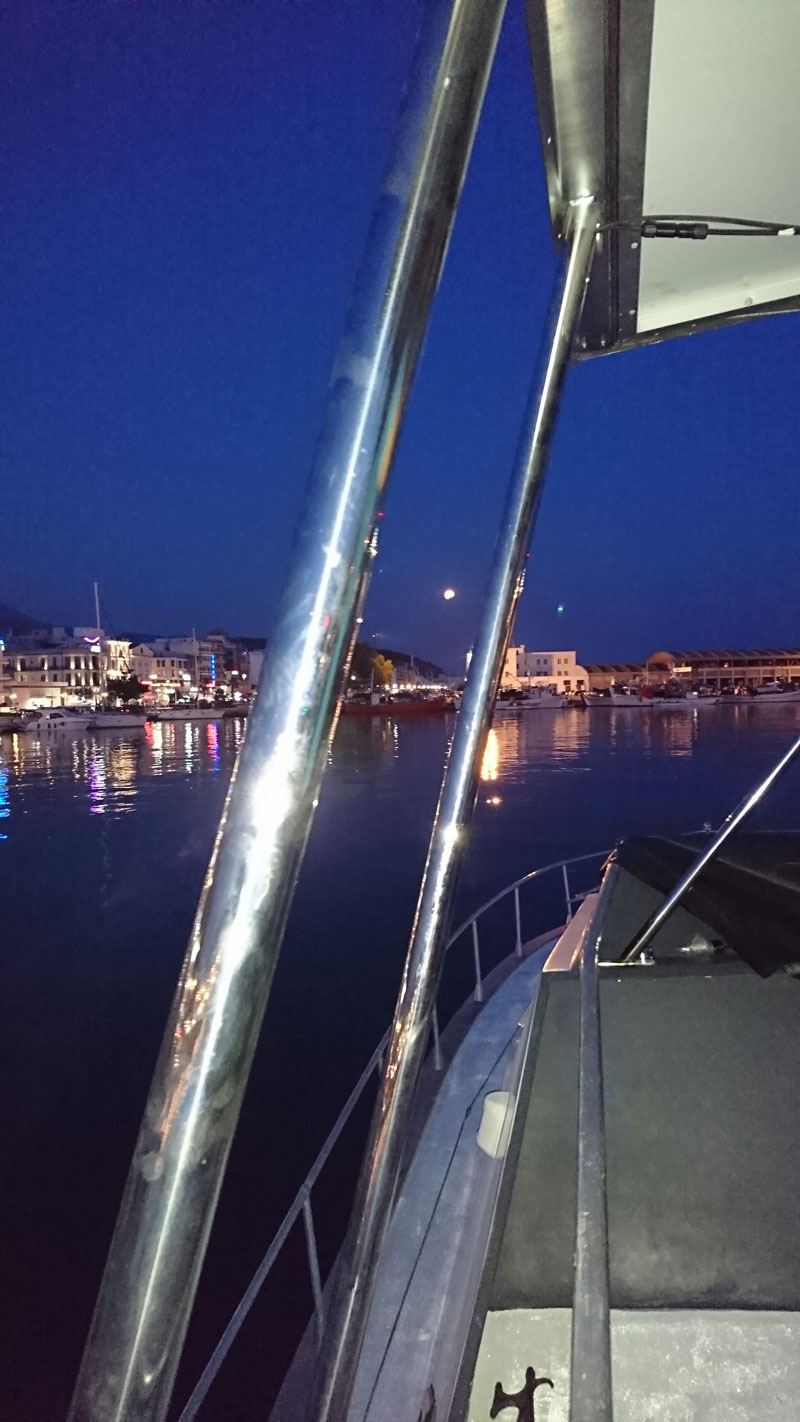

Plan was to have the two side gutters (which are closed on the front as seen in the pics above) to send all rainwater to the aft, so it was important to get the levels right. Which apparently we didn't :rolleyes:
I was hanging up there with a spirit level trying to find the right spot and having secured the rear two pillars on the superstructure when two bleeding liners passed by at the time creating enough wash to almost mess up everything and at some point I thought I got it right and drilled through. Apparently the front two pillars supports on the superstructure need to lift up by 10mm. Not an impossible task which I'll discuss with Nikos and proceed soon.
The other BIG failure was the slanting of the superstructure the degrees of which were measured with an app on my mobile and didn't match the metalwork that Nikos built as a mock on his workshop (using an acurate digital tool). So we have mainly on the front (again) pillars a discrepancy of around 6mm in the 120mm dia plate. That's a serious issue and the solution to it will be to built with George four nice round rings of iroko tapered to match the 6mm (which will be anyway reduced as we pull the pillar plates away from the superstructure). I'll do the first test with softwood at the w/e and see what we come up with George on that. That's a v.silly mistake and all mine!
We are not over yet though...

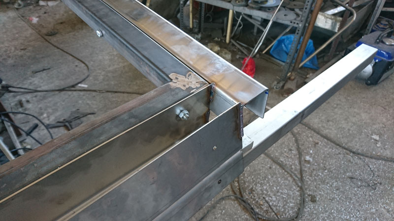

I knew that the construction would be flexing and would need some kind of support so to start with we got two lines to hold it in a back forth movement. If you remember my initial plan was to have a third set of columns supporting the H/T but Nikos was not able to built in in a mock and would have to bring the whole mess back and forth to his workshop which would be impractical (and way too expensive...)
To start with I got two 30mm dia tubes and their paraphernalia to fit from the side of the dash to the main beam between the two panels. Nikos came on the spot and welded them (temporarily) will have to undo them and get the upsidedown V shape to his workshop for finishing off the welds and polishing.
Things improved massively but we still had a bit of a side play, so two more pieces of smaller 25 (or 28mm) tube and the necessary supports were added in the H/T. Rigidity is fully restored and was happy with a F6 we got in the way and when moored in Alonisos.

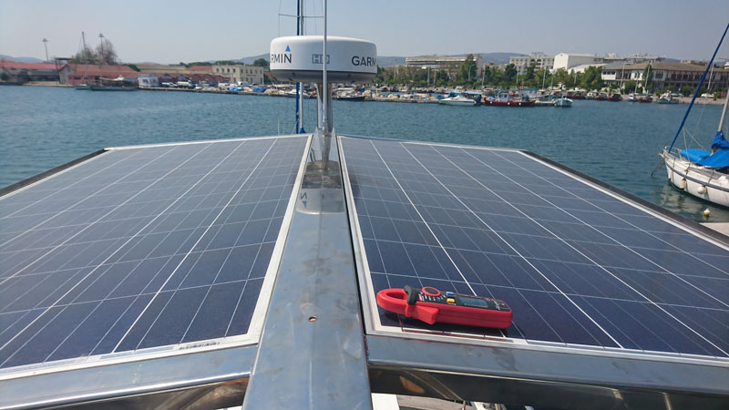

Solar panels are fine pumping 15.5-16A @24V for a good number of hours everyday, pitty my 4X180Ah normal batteries are completely shot and wont hold half that load for half a day... Now that's all sorted, it's time to go for deep discharge batteries, doesn't look I can stretch up to Trojans, so Sunlight seems to be the next option.
Radar worked straight away, still failing with the heading sensor on my A/P so occasionally image was rotated and allover the place. Wasn't really necessary so mainly was playing with it.

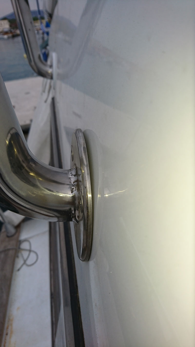

So, started working on correcting what I don't like on the h/t. First was getting the angles of the flanges right so that they make good contact with the superstructure. They looked like this:
So last week I undid the 8bolts holding the horizontal frame with the two solar panels to the stbrd side, plus the 6 bolts on the two flanges and carefully removed the stbrd side frame/pillars. Only needed to prop the rear of the h/t with a 30X50 wooden post. Got them to Nikos workshop and by the evening I had them back repaired, rewelded, re polished, everything. Fitted them with 3mm rubber flanges, bolted them hard against the superstructure and the solar panels frame and it does look absolutely perfect!
Now need to do the port side (only I don't have time). Sorry no pics of the finished article

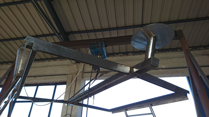

Today after lots of thinking and sketching, I managed to cut and remove the slanted 80mm dia pilar holding the radar 200mm above the frame. It was a horribly stupid idea as unless it's July or August sun angle meant that you had serious shading of the panels (and practically no power to the MPPT controller) So plan is to lower it to just 20mm above the frame and shift it as much back as possible. Pilar and round base goes to Nikos tomorrow in order to remove the pilar, add an extra hole for the cables and fill the existing cable hole in the middle.
looked like this:
marked how I want it modified:
