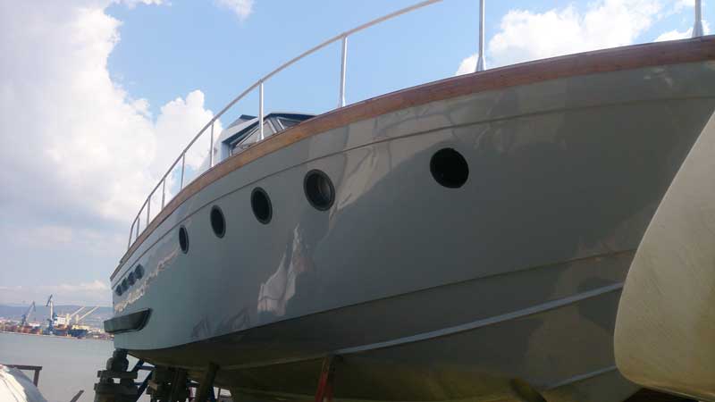

A bit more progress and since I'm talking of antifouling, I had a good study of the "before" pics trying to figure out where the waterline should be. Tried some mental maths on how different the weight distribution is after the repairs of all decks, removal of all the carp, 6coats of paint everywhere (that alone must be 200kgs :p ) and refitting. Adding the bowthruster which is a good 50kg on the nose, shifting the heads towards the bow, adding a 80kg passarelle, adding a 30kg watermaker, adding another 100kg on the new bathing platform, etc.
Anyway, decided that life's too short, and I'll try lifting the waterline 3-5cm off the last actual waterline (with just 300lt of fuel out of 1200lt and full water tanks)
If it doesn't work, I'll lift the line on next liftout. Rather that than going too high and then either having to add coloured lines (which I don't like) or repaint the hull to sort it.

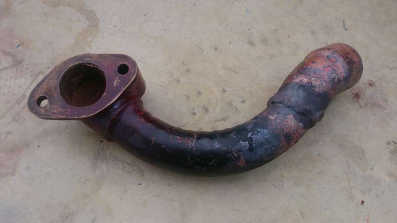

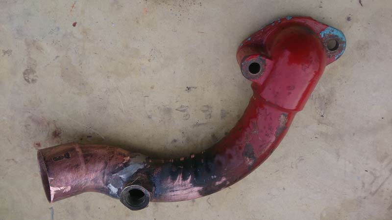

On the engine front, got the sea water exits bronze pipes enlarged and turned from the 38mm outside dia to 45mm that matches the ss exhaust riser water inlet AND means I can use proper exhaust flex hose for them. Costed 7euro for the 45deg elbows from a plumbers shop and 35 for welding them. Currently look like this:
Painted them and will fit them tomorrow. That's the last step before fitting the 127mm exhaust hose and starting the engines.

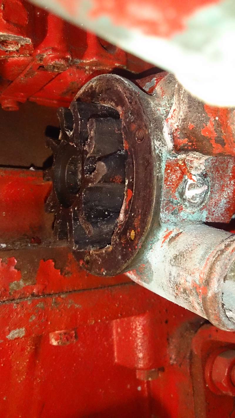

Well, got to finish off the removal of the old impeller on port engine. Got to admit am an impeller virgin and I wasn't impressed with my first attempt. The two screwdriver approach is a pain, wish I could get hold of a proper extractor tool. Anyway after 39mins of sweating (and swearing of course), I'm at this stage (that's around I/4 of the depth of the bleeding thing!)
Cranked the port engine and it moved after 3yrs of rest. Did also check to make sure that the stop solenoids work and indeed they are wired properly and working. Remember, I've messed about all these cabling by relocating the start/stop panel and integrating it in the overall lower helm design.

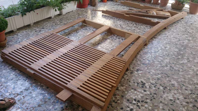

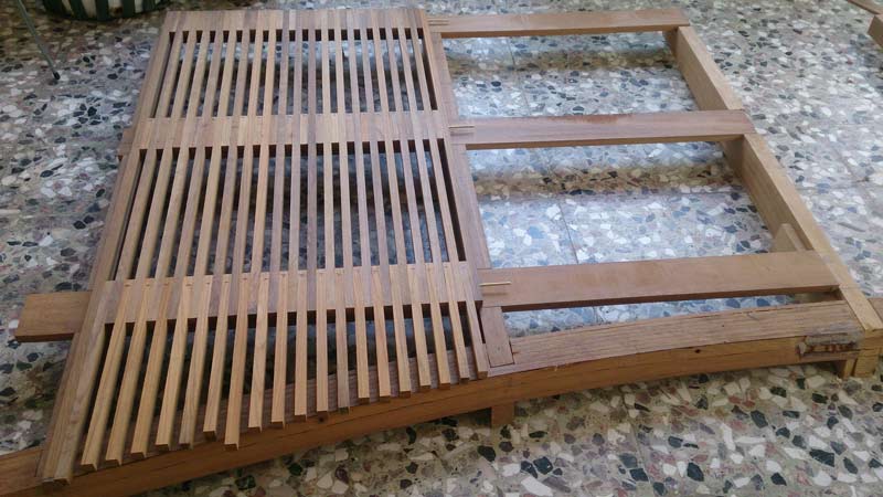

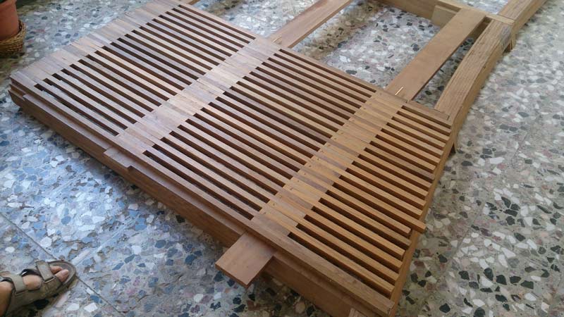

Bathing platform work is progressing, George managed to prepare the first of the 4 teak panels. Test fitted on the frame, looks perfect, guess the colour differences between the pieces will soften under the Med sun, rather quickly!

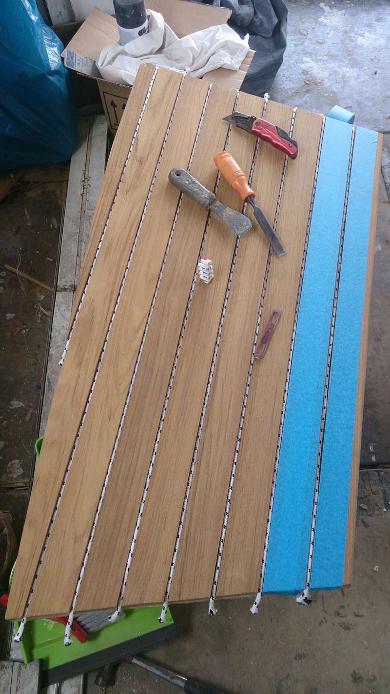

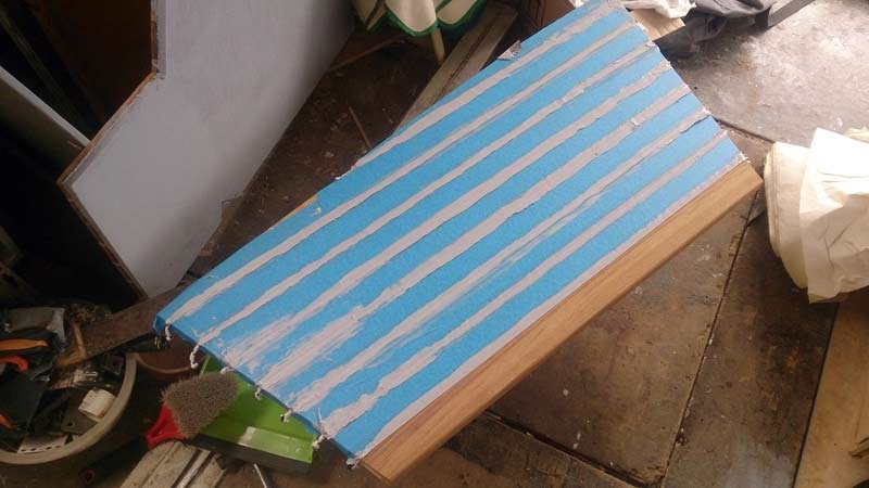

Starting finishing off small bits of work leftover over the years. A heads panel wasn't caulked for some reason or another, so went through the process last night. Now looks fine, waiting for it to dry for at least 4days before sanding and fitting.

Bathing platform all done waiting at George's workshop.
25 and 32mm dia tubing for the platform frame support bought and waiting the fitter/welder

NICE!!!! NICE !!!! There are Manufacturers who would die for a hull finish like that. i do not believe that an appropriate superlative exists that adequately describes this project.
