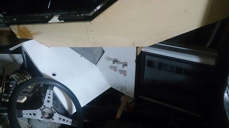

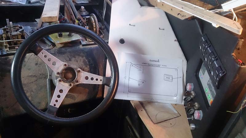

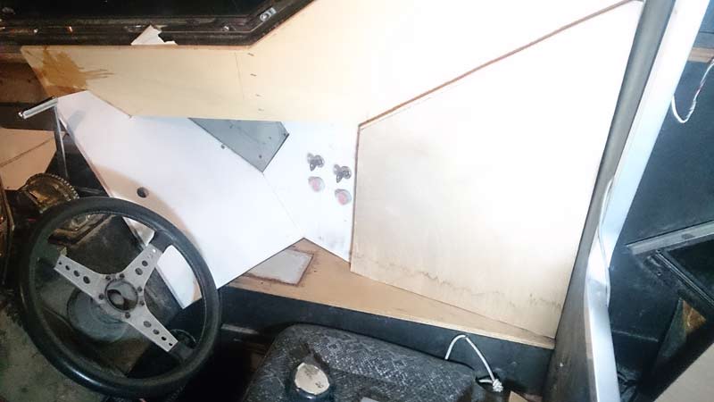

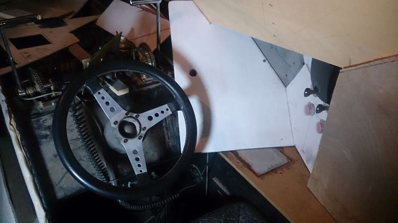

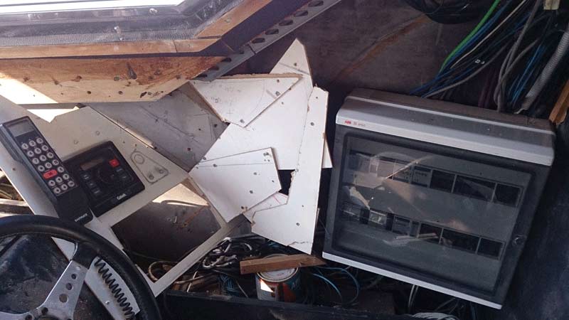

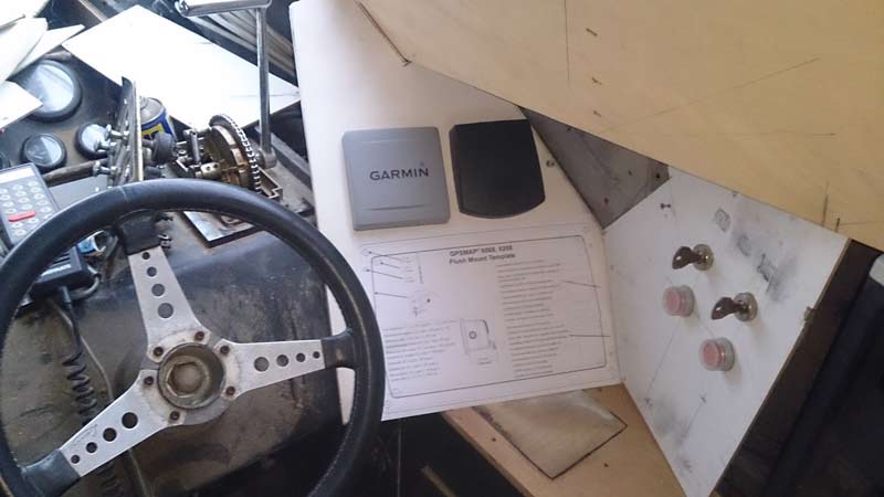

lower helm has progressed through a series of ideas and iterations shown next.
next pic shows everything in place even the "door" covering the new el/panel. This will be lacquered, whereas the rest will be lined:

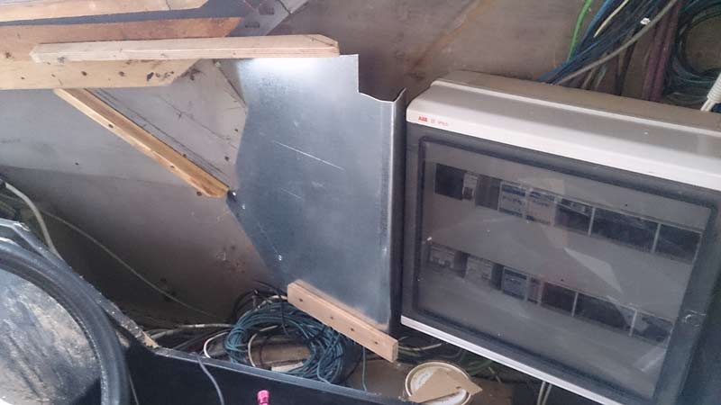

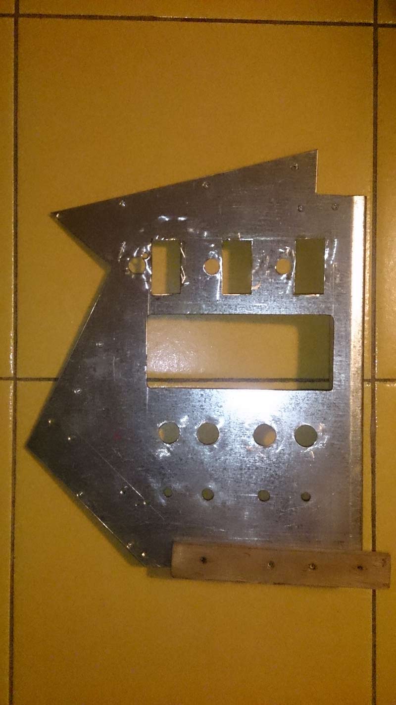

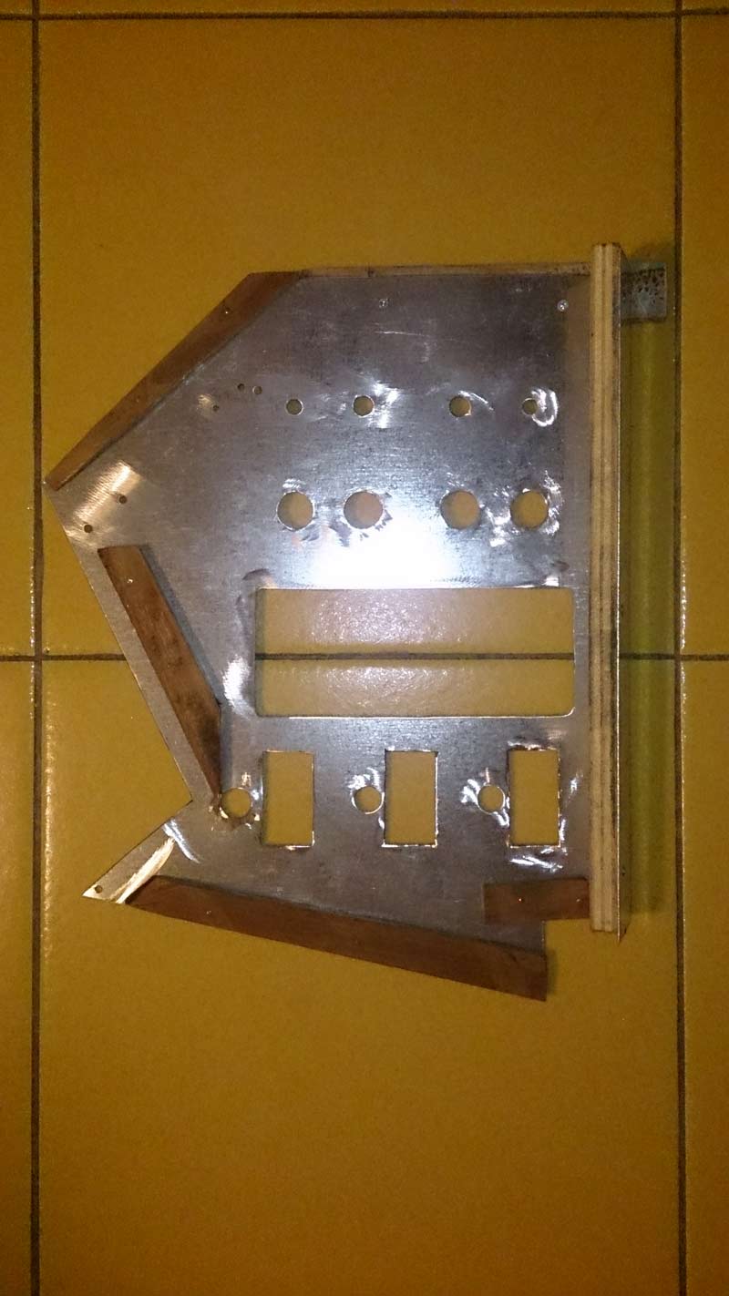

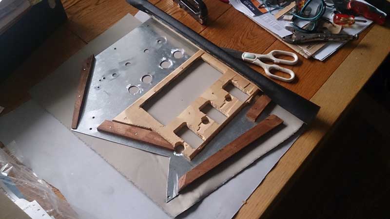

eventually, finalized the angles/layout of the side panel, got it cut and formed out of 1.5mm galvanized steel and got it back in the boat for fitting. Fitting alone took a few hours...

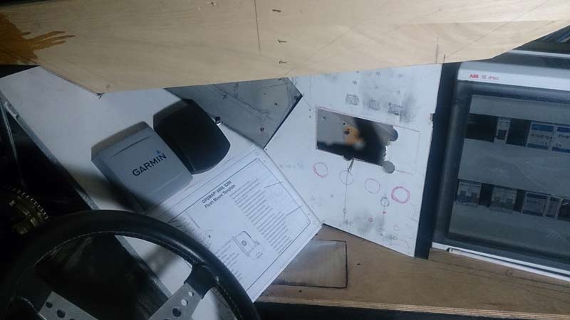

At that point I decided to change the layout yet again and to squeeze wiper controls, engine on/off, gen panel AND the three bilge controllers ALL in there. Didn't seem possible initially, but eventually turned out more than feasible once I changed the layout and scrapped the box where the wiper controllers were in. Further on the slanted panel and above the chartplotter it is possible to fit both the a/p cetrek control AND the autoanchor windlass control and have space above them for the b/t and horn button. Seems that vhf wont fit in this layout so I'll hang it on the side somewhere, not decided yet.

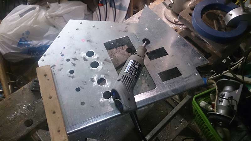

Today I did all the drilling and cutting in the steel panel and I'm almost ready to line it with black vinyl. My experience from lining a steel sheet with vinyl from the engines' gauge panel (which currently looks carp and has to be relined!) was that there's no fcking way the vinyl under all that heat will live and stay glued WITHOUT stretching it and stapling it onto something. So I cut iroko leftovers into strips and bolted them with countersunk screws onto the panel, so that I can stretch over and staple the vinyl ;) Worked out quite well, just took an awful lot of time. Further, I have to cut to shape a piece of ply to line and give thickness around the genny panel and the bilge control panels. This I haven't yet done as I run out of time, but it's needed so that I can bolt the genny aluminum panel onto it. Once done, I can stretch the vinyl and start assembling the pieces of the puzzle. Will use a 3mm foam for a bit of a plush feel to it. Also smoothens out any screwhead detailing and other blemishes in the panel.
Dremel was invaluable, took me 6 smallish cutting disks to do all this cutting:
following pics are awful, but it's almost midnight and I cannot get any natural light on them so flash reflections of my phone make them look really bad.
TBH, feel very relieved with this out of the way, as I can wire all things up and only need the three buttons for nav lights plus the bowthruster and horn controls on the slanted panel.

weekly progress report time!

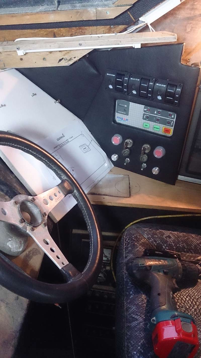

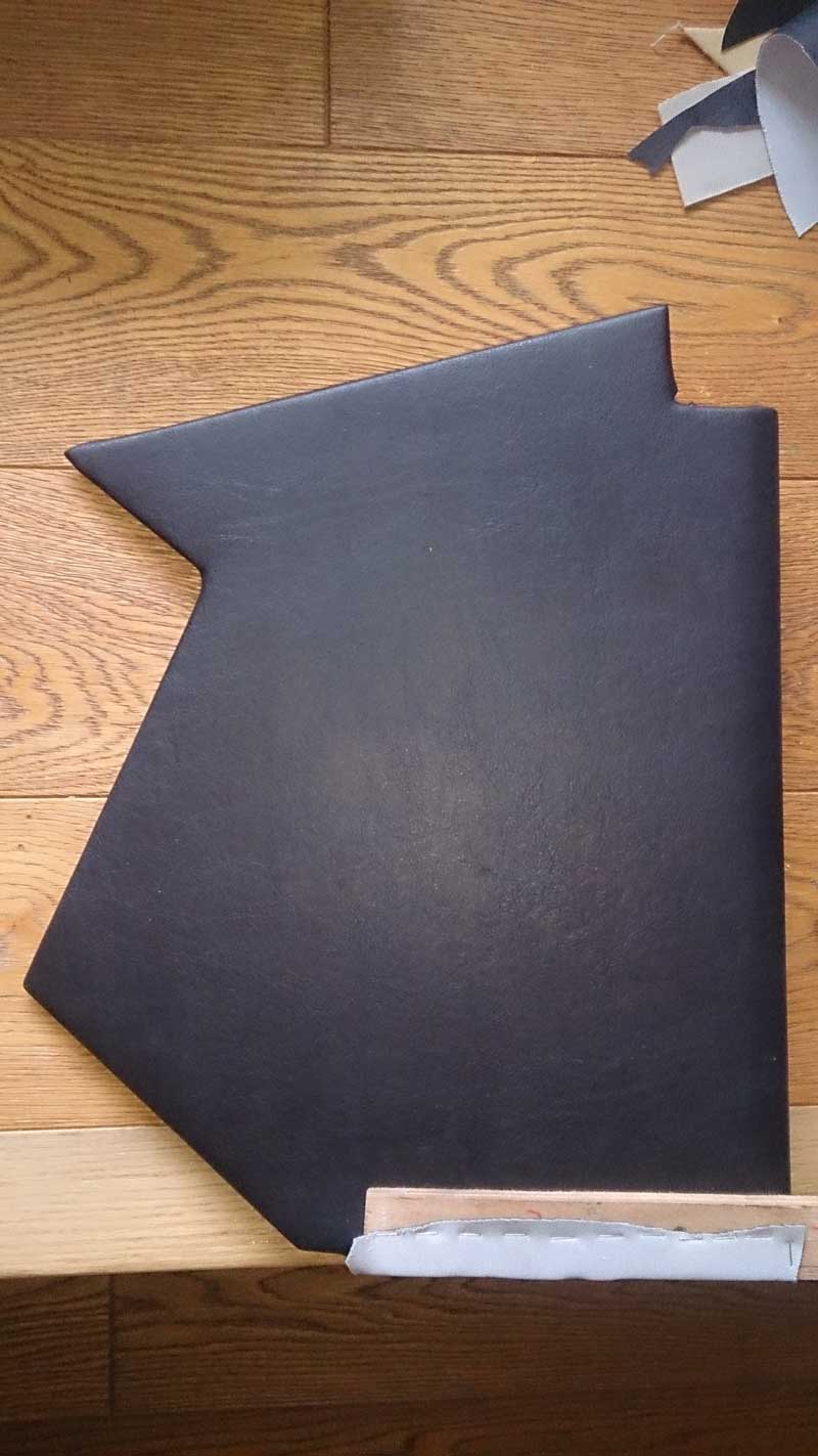

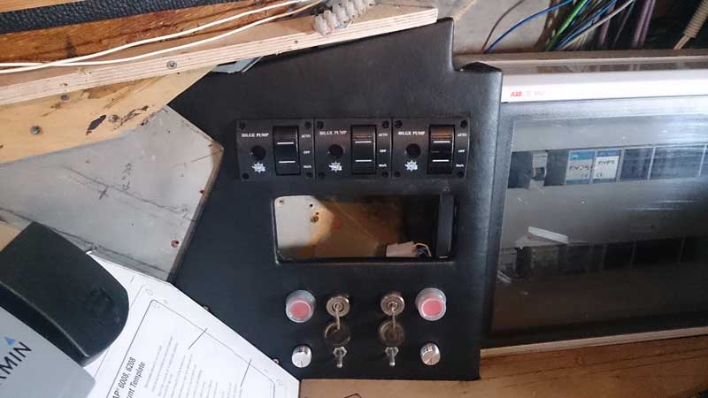

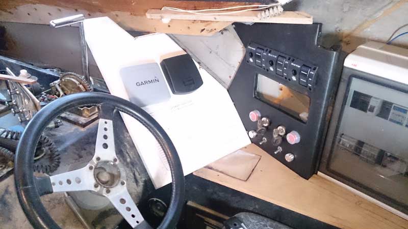

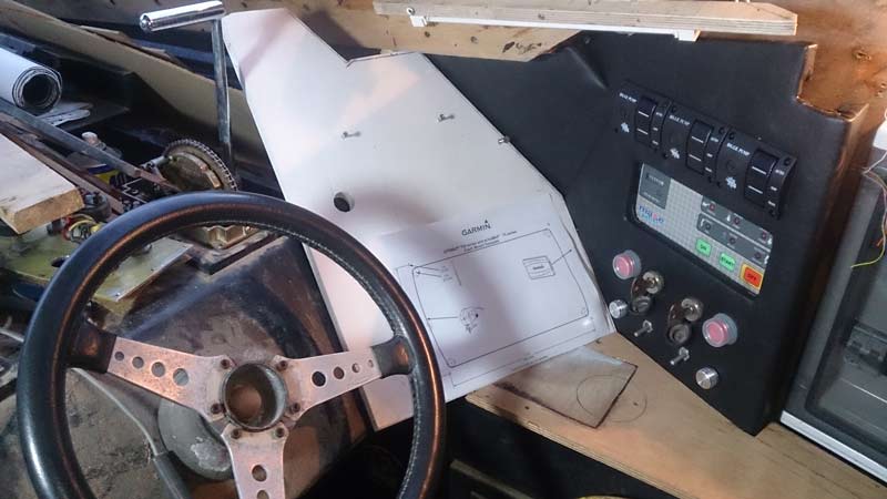

Managed to finish this complex panel, all nicely upholstered, cables lengthened, bolted on in place and ready to be fitted.
test fitted in situ:
and then back home to finish off and lengthen 14 wires connecting the engine on-off key and buttons to the central wiring loom behind the gauges panel. Unfortunately when I originally designed the thing keys were meant to be 20cm closer to the gauges and now cables weren't long enough.
Quite happy with everything, but need to rethink the stretching of the lining over the hole of the gen control panel. Bevels (or is it chamfers) too tight and lining wont stretch properly, so thinking of forming a thin sheet piece and covering the edge with it.

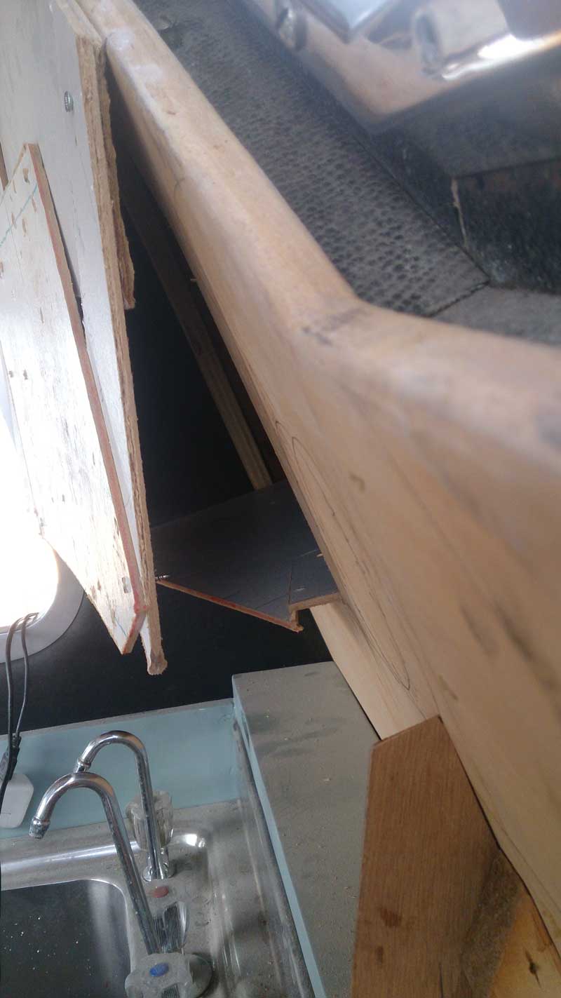

Opposite, on the galley area, sorted out the size of the cabinet on top of the sink, formed the "floor" of it and have it ready for George to take over and built the cabinet. It's slanted outside the lining panel and vertical to the panel between the panel and the outer superstructure ply. Make is possible to construct as a whole and fit it in after lining the panel. It's high enough for a mid shelf, but still thinking if it's going to be a plain shelf or I'm going to lasercut "seats" for various glasses. Was thinking of skipping the "seats" but instead put the hinges to this thing on the bottom so effectively folds "out" making easier to catch something before it drops as you try to open the cabinet after a bumpy ride ;) Further opening it up (and having a 20-30mm lip around this "door") means I have a bit more space to organize laying out things around there when preparing or serving. Also not so keen on having a proper thick back to this cabinet, will probably upholster the superstructure ply and have the cabinet just rest and squeeze on top of the upholstery. Slightly tricky to get it right with no gaps, but I doubt I'll get it that wrong that a wine glass will slip in between :p I also understand that constructionwise it's not a proper design, but I can live with that.

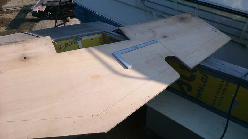

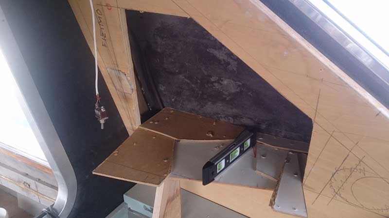

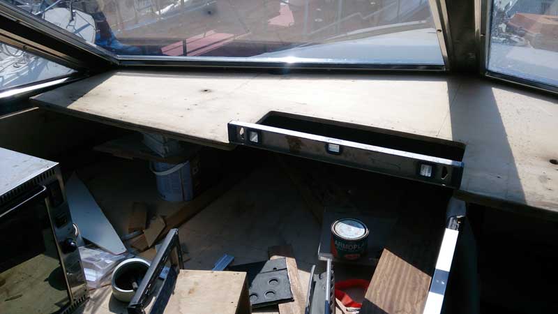

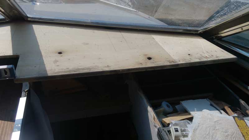

Finally, the dash under the windscreen had at last the main panel trimmed and test fitted. Panel originally was around 150mm lower and slightly slanted meant a two step cut process to get it right. Now it clears over the wipers' motors and I have to invent the detailing towards the side windows. A lot of head scratching hasn't produced the goods today, will work on it and figure out something...
in place, note the missing piece around the spirit level, there I'll have to put a patch as its only use was to clear the Sailor VHF on the much lower dash. Now, it's just a matter of putting it back together.
awkward detailing to be sorted out:

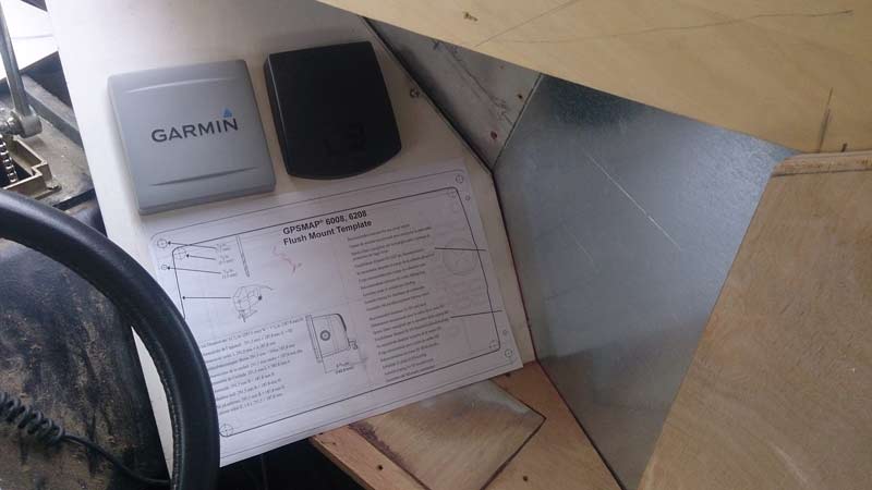

Changed my mind (yet again!) on where to fit the old classic VHF, so now the sailor seems to be finding a spot way behind the gauges, leaving the central area just over the staircase free for a decent size cabinet (or most likely a deep drawer). Managing to utilize all space around there which is good.

Stretching the vinyl around corners like you need for genset panel is close to impossible. The alternatives if you cannot front mount the genset panel include (a) a big radius in the plywood, and live with the look (b) or do what my builder has done and use a super stretchy vinyl, and (c) stitch it neatly like a car dashboard to create a 3d shape to the vinyl -I would mention at this point the beauty of a Sailrite sewing machine but Deleted User would mention Mumsnet :D Also you could find a very fine frame section, take to a picture frame maker to cut/mitre/staple, then spray in black paint - quite a faff though.
I would be careful with those bilge pump switches. They are clearly made to look like the uber good quality Carling Contura switches but they are clearly NOT genuine Carlings, so they might be Chinese knock offs. Maybe they are fine, but worth checking.

LOL, I guess Osculati should have rather avoided to put their logo on those switches, if they wanted to disguise them for Carlings... :) Which they also sell, btw.
Mind, I'm neither saying that they are of equally good quality, nor that they aren't made in People's Republic, but they are pretty popular stuff, and fwiw for I've yet to hear anyone complaining about them.

true, haven't managed to find superstretch vinyl in similar colour/texture around here and tbh I cannot be bothered. I was hoping I'd be able to do a thin (around 5X10mm) section of iroko to smooth and cover the edge, but this panel you see has costed me around 25h from design, mocks, headscratching, more mocks, cutting on laser, test fitting, drilling, securing iroko strips to stretch and staple the vinyl on and finally fitting all the bits and bobs on it. Two hours alone were the redoing (and soldering the tips!) of the 14 cables from the engine on/off switches as they weren't long enough to meet the gauges panel and I wanted to route them carefully and securely around. Spending another 3h on a tiny strip of wood is not high in my priority list and should be able to do it on the spot. Next time I'm at my lasercutter's place, I'll get a 10mm by 2mm thick strip of alloy to stretch/bend around the cross section. Got a spray can of black colour laying around, so that will do it ;)
OK, now I know that my switches are copycats of Carling (I only knew of an awful lager under that name), so thanks for broadening my horizons John :p
P., they are NOT Chinese, they are proper Taiwan stuff :D
Haven't bothered opening one up, but feel quite sturdy anyway. I bought them as they were branded Osculati as MM points, they were reasonably priced (not the cheapest available and not stupid expensive) and the switch itself felt very solid and well rated at 15A at 24V. Bearing in mind they'll probably be sitting all their life in a nice warm environment (lower helm even now is 20C with 10C outside, reaches 45 easily during the summer) in the AUTO position I doubt they'll ever fail. Only thing I'm not sure is if they lightup when bilge pump in operating (would be a useful addition, may drill them up and install a small indicator bulb not sure and definitely not now)

On my Garmin chartplotter and autopilot front, a lot more reading and still unsure of certain details. Good thing is that my neighbor with the P45 is happy to buy the GPSMAP 3006C for what I paid for (plus cards/reader) - that's around 300euro. Bad thing is that I need to get a NMEA0183 gps mushroom for it and the cheapest no name I've found on ebay is almost 100euro. No s/h around for some reason, what do ppl do with their old mushrooms? leave them up the radar arch indefinitely???
Anyone got one going cheap, I'm interested!
Wasn't planning to use one myself, as having a N2K network I can get 0183 signals from a GMI10 to the 3006C, but he's got some ancient stuff I think Raymarine and I'm not even sure there's any backbone or other way to get the data across.

Quite right, I put up a post in the wanted section just in case. I've only found a half painted red :eek: and with cable cut 5cm off the mushroom from the States but that still will set me back over 50euro...
Anyway, got the panel back in the boat this evening, test fitted it and it looks perfect, quite pleased:
I'll get it fully connected and leave it there for the time being, I'll also line up the "floor" so to speak next to it and wait for the final decision and purchase of the chartplotter I'll use before drilling holes and finilising the slanted panel.

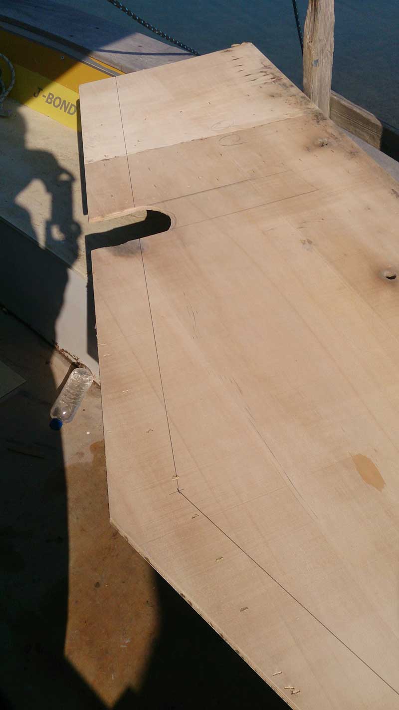

Spent a good two hours with George designing and detailing the galley ex-charttable cabinets. Should end up looking great as we have lots of 10mm thick by 120mm wide 2m long planks of iroko that will be joined together and epoxied on a 6mm ply. Further he'll sort out some solid 16mm thick edging and get the whole wrap around the oven done in one go. Having the dash (whatever you'd call the under the windscreens flat panel) in place, we calculated the size of the folding up door panel and sorted out how the massive central drawer will work. Difficult to visualize, will have to wait for the pics I'm afraid.
He also got the necessary mocks and side panel for the galley above sink cabinet. I hope there's going to be some progress by the time I'm back.

Looks great Vas.
Is that snake skin on the helm seating in the first picture? Was that original spec?
thanks wakeup,
yep, genuine fake snake skin that is. Actually the WHOLE bleeding salon is covered in that ****...
Previous owner's mate was very proud for the job that he did. No idea what was originally there.
Needless to say it's going in the skip. You want some FOC? :p
It's in surprising good nick for all these years, haven't even managed to tear it will all the tools and stuff I've thrown at it!
Not quite sure how I'm going to reupholster (or rather redo!) the lot, but the cushions on the sofa are really fluffy, deformed and awful, so looks like a rebuilt job is needed there as well.
