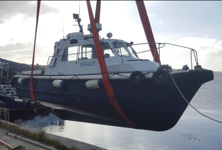

Hi guys, sorry to hijack on this post! I'm an owner of a Mitchell 31, she's twin screw and shaft driven running 220hp Ford Mermaids. I know that she was one of two that were built specifically for a Saudi Prince in the early 80s, I have paperwork to back that side, but I don't have any information on what model she is. Any help would be greatly appreciated! Screenshot_20230605-184144_Gallery.jpg

Hi guys, sorry to hijack on this post! I'm an owner of a Mitchell 31, she's twin screw and shaft driven running 220hp Ford Mermaids. I know that she was one of two that were built specifically for a Saudi Prince in the early 80s, I have paperwork to back that side, but I don't have any information on what model she is. Any help would be greatly appreciated! View attachment 157785
Very interesting, I would agree with Ben that it’s based on a MK3 especially wheelhouse side screen and three window windscreen but coachroof forward is a bit unique. There is a pretty active Mitchell 31 Facebook group worth joining, there would be a lot of interest in your boat.

Thank you gents! I will pop on Facebook and have a look. Yeah, she goes! She'll economically cruise at 17kts and tops out at 22knts. I've worked her for the Falkland Islands Shipping Agency for the last 9 years and loved her that much that managed to convince them to sell her to me haha
