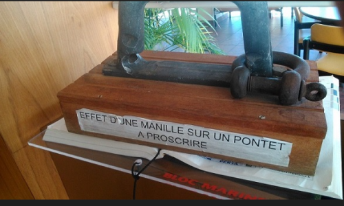

i have just moved onto a pontoon berth and plan to attach to the cleats with shackles as I have got made up lines with spliced hard eyes. How do marinas generally feel about this as I wonder about a stainless shackle damaging the galvanizing on the cleat?
It is not a problem I have since we have steel hoops rather than cleats. I think if it were me I would use lines with loops and cow hitch them to the cleats, not ideal but should last a reasonable time.

Agree with the other who suggest removing the hard eyes and not use shackles.
Add sacrificial abrasion sleeves and renew as necessary. Hosepipe works, hollow dyneema tape works (but expensive), sewn leather covers works - lots of options. You need to add many of such covers before the eye is made, obviously.

I used a piece of chain (18-24") encased in a length of lay-flat plastic hose; doubled around one leg of the cleat.
The pin of galvanised bow shackle passed through the two end links of the chain, and its bow passed through a galvanised thimble spliced into the end of the mooring line.
The marina manager was happy with that.

Suspect it depends on the amount of swell/movement the marina suffers from. I shackle on to the cleats of my home berth with no ill effect to the cleat evident or dark mutterings from the marina. Must admit I thought our cleats were an alloy, not galvanized, but I could be wrong there. Shackling also tends to reduce 'borrowing'.

I was in marinas that had metal hoops for mooring lines. hard eye and shackles were obvious for permanent mooring lines. The second marina did not did not allow shackles as concerned they would quickly remove the coating from the hoop. I spliced sacrificial loops from hard three strand rope and cow hitched them through the hoops and hard eyes. They would wear after two or three winters but no chafe on the stretchy nylon mooring lines. Now use the same method through the middle of cleats in the current marina with the mooring line tied to the rope loop with double sheet bends. This leaves the horns free for neighbour boat to use without disturbing my lines.
