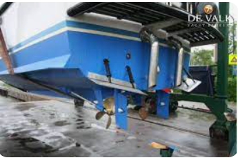

I believe it is steel - displacement of some 11 tonnes. Despite the hull design not a truly planning shape, I'd be surprised if 500 horses would be able to push it very fast.
Trim flaps indicate that someone wanted to lift the stern but still, 11.000 kg is a lot.

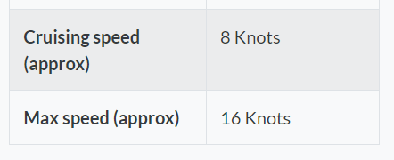

Another ad (for a 2 x 230 hp powered) states

I seem to recall the larger twin engine ones could do high teens speed wise but I would imagine fuel consumption would be a tad high !
Major worry with that boat should be 30 year old teak decks on steel plus as Greg says the paint systems back then aren’t as good as these days.
Nice boat mind.

It was offered also with 2 x 303 hp (Iveco?), so 2 x 250 (500) hp would be mid range

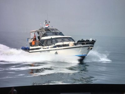

I found this photo on google.looks like they can get up and go alright
I stand corrected.
I had been thinking about it and our Hardy is around 9-10 tons with 2 x 265hp engines - probably less in reality as Perkins over-egged the HP designations - and we can cruise at around 12 knots and make 18 flat out on a good day. Fuel consumption prohibits that kind of nonsense of course 😁

Unusual exhaust porting and a lot of boat below the waterline.
