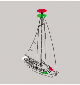

Why no discussion of red-over-green? It is a legal option.
Colregs requires it for large sailboats, but never implies that it is NOT acceptable for smaller boats. Years ago the power requirements were unattractive, but not anymore. It also has the advantage of providing light both high and low, and multiple lights rather than a single point. Easy to remember: "red-over-green, sailing machine."
RULE 25
(a) A sailing vessel underway shall exhibit:
(i) sidelights; and
(ii) a stern light.
(b) In a sailing vessel of less than 20 meters in length the lights prescribed
in paragraph (a) of this Rule may be combined in one lantern carried at or
near the top of the mast where it can best be seen. [note that this is only an exception for small boats--nothing implies it is preferred.]
(c) A sailing vessel underway may, in addition to the lights prescribed in
paragraph (a) of this Rule, exhibit at or near the top of the mast, where they
can best be seen, two all-round lights in a vertical line, the upper being red
and the lower green, but these lights shall not be exhibited in conjunction
with the combined lantern permitted by paragraph (b) of this Rule.
Discuss why or why not. It is what you have long seen on larger yachts, because it provides better visibility.

Two aspects come to mind, IIRC the Colregs Annex I
Being "all-round" they should respect the "less than 6° obscured sector" requirement, which would rule out mounting anything below masthead, there are sails up and the obscured sector would be a lot larger.
There must be a minimum 1m vertical spacing between them, not sure it would be entirely practical to have a long pole above the mast.
All-around. True. The solution, which I have seen a few times, is to mount two green lights on both sides of the mast, 1 meter down. In fact, with two lights, the blocked sectors even with sails are quite small, and the light goes through and reflects off the sails (as other have nentioned, this is a good thing). The red on top is easily done with an all-around. As for the sails, that was a USCG image, so they are OK with it and I am in the US. International, I could not say.
No pole above the mast needed.
This is what I would do, rather than a tricolor.
Hmm, that makes 6 lights instead of one. Surely an option, I personally would not go that far, the tricolour hasn't given me any specific problems until now :)

Just made a quick scaled sketch for a masthead rigging and a hoisted genoa, the lower leeward all-round green light 1m below mast head level might possibly not exceed the 6° obscured sector requirement while running downwind, all other points of sail would not be compliant with international Colregs Annex I. As you say the US has slightly different regulations.
Actually, the US reg is Colregs verbatim, identical. But the image is in the printed regulation, making it a valid interpretation in the US. Internationally I have no personal knowledge... and for my personal use it does not matter.
You could add a light mast above the top of the mast. It would only be 18 inches above your antenna, so not that much more height.
BTW, I think you get it, but for other readers, for the purposes of Colregs, the top of the mast is not the masthead. The masthead is about 1/3 down and is where the steaming light is. This too is in the Colregs appendix. Also, vertually none of us have a fore mast. We have a mainmast and we might have a mizzen. Perhaps someone has a schooner.
One advantage is that you will have both high and low lights. Also, they are separated, so there is much improved ability to estimate range.
