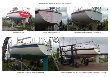

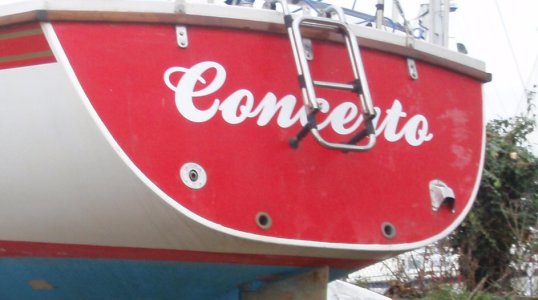

I had a similar problem with Concerto, she had a dull creamy gel coat and had a red hull stripe with a red transom. This composite photo shows what she looked like and the steps in removing the red transom and bring the gel coat back to white.
This shows just the transom before and after returning to original gel coat. I should mention there were 6 different colours of red paint and it took me 4 days to complete.
More detailed information is in this PowerPoint presentation.
https://wiki.westerly-owners.co.uk/images/3/3f/Concerto.pdf
