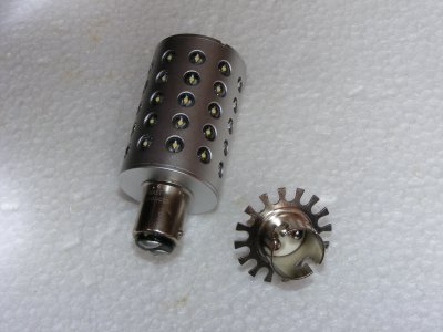

Dingbull's new holder something like mine I guess
What brand is that, if I may?

Sorry no idea. I bought it a good few years ago from either Force4 or SeaTeach. ( the latter I think )
I was expecting a bulb that would fit the Aqua Signal lantern without modification but it really did need the holder to be orientated differently.
Exactly the same!
