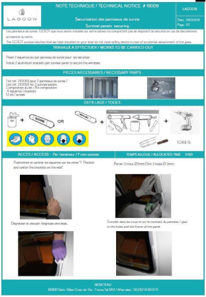

I guy we know was sailing from Antigua to Guadeloupe. One of the escape hatches popped out of the hull on passage. These hatches are about 9" above the waterline. They are toughened glass and glued in place. The idea being, that if the cat is inverted, you have a little hammer to break the glass.
This is another failure of bonded in windows but unlike those on deck, this has a really possibility of sinking your vessel. The boat is 10 years old. Obviously they are not suffering from direct UV damage. Quite possibly heat degradation. Anybody who has bonded in windows or escape hatches, on a similar aged boat, would be well advised to have them all re-bedded prior to any offshore sailing. Can you imagine if you were on an ocean crossing and the escape hatches fell out!
The owner explained that they have had to re-bed the saloon windows already as they were all leaking.
I have heard so many times that bonded in windows are as strong as the boat, blah, blah blah. Well they are not. Bonded in windows are as strong as the failed adhesive.

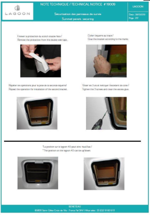

Did his cat escape the recall?
Survival hatch: Goiot explains the product recall aboard catamarans
Adhesion defects on 2 models of escape hatches​
" The recall campaign concerns two models of escape hatches from our range: the T44 fixed hatches with an aluminum frame and tempered glass and the Cristal 4942 opening hatches with a PMMA glass and an aluminum frame. Difficulties of adhesion that could lead to the loss of the glass have been noted. There is no risk with other fixed SurvivAL or Cristal round and sheet metal models. Affected products are those produced between August 2014 and December 2018 for the T44 and August 2014 and July 2018 for the Cristal "says Jacques Leblais, CEO of Goiot Systems.

Maybe. Its a 10 year old boat. His has the fixed glass, not opening.
'Difficulties of adhesion' interesting wording. Lagoon front windows are notorious for failing. They are are just glued in. We know several Lagoon owners and they all have problems. It's not an age thing or batch issue. It's a design issue. The issue spans different size Lagoons.
