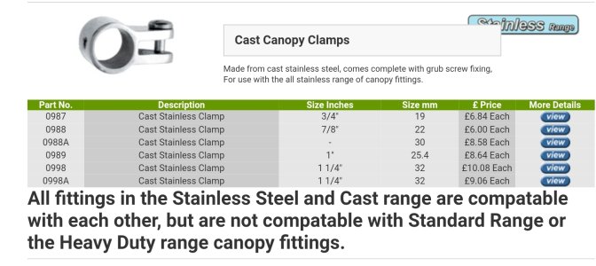

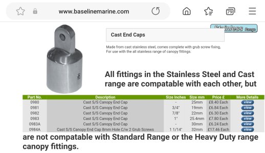

And if you could make it over to Lee on the Solent to Baseline then you'd be able to actually hold them and see how they look for suitability.

How are you progressing with this.
I have some connectors for tube that I used, and then discarded in favour of welding and I could take some pictures if it would help.
