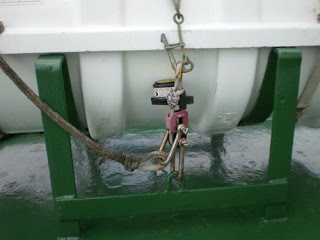

However, the question above relates to the weak link. This is the red section and is where the painter is attached. This red section actually slides down over the black section sort of a hoop within a hoop. The actual weak link is on the black section and it looks like a bit of plastic, however it is actually 6 strands of steel cable inside the black plastic. I could not break this just on my own, but managed to break it by twisting a screw driver around.
I believe that this weak link is perfectly strong enough for normal use and I cannot envisiage it breaking in normal use. If it did fail, perhaps it was an older unit - maybe this is why they have a 2 service life?

The painter is attached through the weak ling AND Main part of HRU Securing.
In this case the rope with the shackle is the painter and the Faded red plastic is weak link. You can see a senthouse slip for releasing the L/Raft for manual deployment above.
Until not toooo long ago the weak link used to be piece of red rope, but most ships rigged them wrong so they simplified the design.
