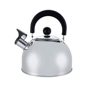

Not much use on an all electric boat.
That's a good reason to dismiss all electric boats rather than the kettle, 'cause a gas cooktop is better also for cooking! :encouragement:
In fact, I'm a bit surprised to hear that WL doesn't have it on his boat.
J, was the original cooktop replaced, possibly?
MapisM, I agree gas is better for cooking, but the all electric boat is a reality and needs work arounds. My cooktop is a Kenyon and apart from the electric rings has alcohol burners which we have used with success.
Fairenuff, whatever works.
'Fiuaskme (and my wife), we would have surely got rid of an all electric cooktop, if we would have gone for a boat equipped with it.
In fact, replacing it with the typical one with an electric burner (just in case) and the others on gas is no big deal, in most boats.
But each to their own, of course!
took it off.
it was horrendous and anyway I dont like gas on boats.
