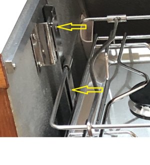

@Pete7 that looks really smart. Did you strip an old cooker for the gimbles and pan retainer things?
Pete7
11 Aug 2004
4,085
Gosport
Yes, because new ones are chrome plated or something, whilst the old ones are stainless steel. So an hour with a brillo pad and they cleaned up lovely.
Next problem is the gimbal position has to be changed, because I didn't have 14kgs of oven hanging below. I bought a couple of spare gimbal bits and fitted them back to back with the existing ones which lowered the "deck" of the induction stove to the same position that just a gas hob and grill would be. Again you can buy the right ones for just a gas hob and grill, but difficult to find anyone who actually has stock.
Pete
