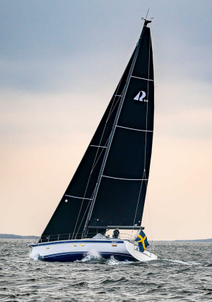

Some good reading: Major leap for effortless performance - Carbon furling mast
