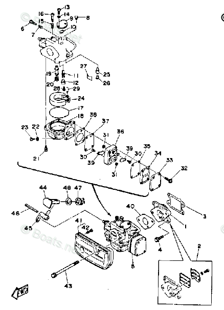

The Malta's filter ( or strainer as it is called in the parts list) is in the tank outlet , #26 in the diagram below
