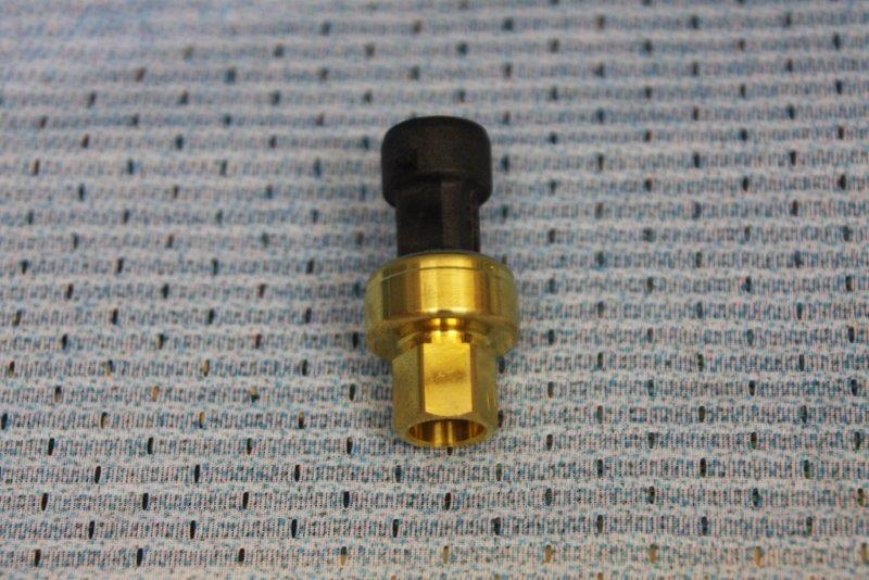

This is the boost sensor (881708)...
If your mechanic is suggesting that you start tampering with the EDC unit itself then I would run away very quickly and find a new mechanic.
What I would recommend is that you or your mechanic carefully unplug, check for corrosion and clean every connector. I had a weird intermittent issue causing over-revving and over-fueling and this seems to have been cured by simply cleaning the connections.
Very kind of you to provide a picture of the boost sensor, thank you! I reckon that the top is where the connection to the EDC is located. Pictures from other angles would be great. Well, tampering with the EDC unit itself is inevitable if the boost sensor is malfunctioning. Its either trying to replace it or buy a new EDC unit at ten times the cost (3000 euro). If you mean tampering with the EDC unit yourself I can understand, but I can always handover the job to him if I feel overwhelmed.
I definitely agree that examining the tube from the manifold to the boost sensor is essential before even considering removing the EDC unit. I have not paid any attention to that before and didn’t have the time last night. Examining the connection from the boost sensor for corrosion means I will have to tamper with the EDC unit as it is imbedded in protective material together with the EDC circuit board (as I am sure you know). Sadly the EDC corrosion protection is mostly about VP revenue protection as I think there are other less destructive corrosion protection methods available. At least the boost sensor need not be imbedded in glue together with the circuit board. Removing the EDC unit from the body is not that complicated, but if you can share your experience of replacing the boost sensor in the EDC it would be very helpful.
Changing the boost sensor is a very easy task , it just pulls away from the gel like cover .
If he isn’t up to the job then as said move on .
Thanks, that is good to hear. It is more the other way around and I enjoy working on the boat. But getting it right is more important than enjoying or saving money.
