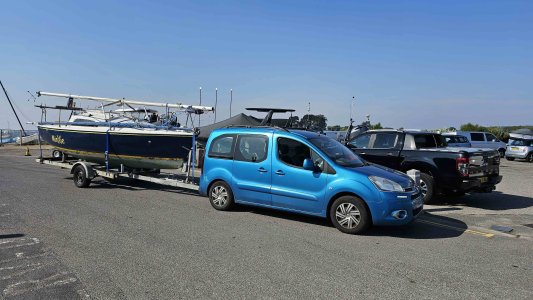

Well we did it! Force 6 motoring across Poole Harbour, was really worried it would be very windy in the car park, but we were in the shelter of a building. I took the boom and stackpack off, attached the main halyard to the pulpit and winched it tight. I rigged up a makeshift A frame out of 3x2 timber and I was about to attach the trailer winch to let it down slowly. The main yard guy then said "nah, you don't need that, we'll just let it down between us. I held the furling drum back, one of them let the halyard off and another guy on the coach roof took the weight. It came down nicely controlled, reasonably heavy but not too much.
Thank you so much for the helpful advice and comments. Now I can work on a proper rig to enable me to do it single handed. Cheers.

Now we see the boat, i see it has the "blade" type mast pivot so as already mentioned it is important to keep the mast central while raising and lowering. Press ahead with the A frame and you should be good to go.

Thanks. Yes, A frame all the way, and bridles on the pivot line for side to side. We're moving to Fowey in a week so it will have to be a trailer sailor. There's a 10-20 year waiting list for moorings evidently! Looking forward to next year's rally in Fowey if there is one.
