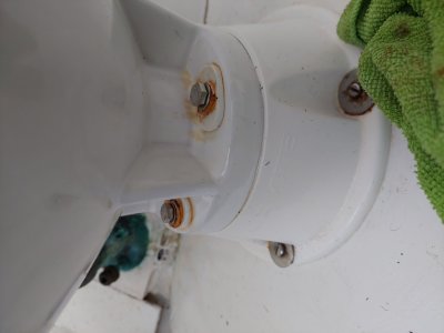

Assuming the bolt and washer are both 300 series stainless steel, check with a magnet, then you are seeing mild crevice corrosion.a blob of sealant will prevent it.
An option would be to use a rust blocker - ACF50 or XCP rust blocker are about the best, I use them on motorbikes & under cars, they're both very good...
