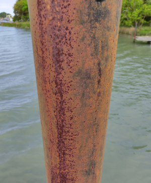

I've got 4 steel posts/piles on my drying mooring, the piles are in good condition but have got quite rusty.
Should I apply a rust convertor first, or can I get away with a direct to metal paint.
Would appreciate advice on the best way to go about this.
Thanks

Anything you apply has to resist the friction where the pontoon slides up and down the pile; there are usually rollers. I can't imagine any paint lasting more than a few months at most under those circumstances. The piles on every marina I've been in are simply allowed to get a nice rusty patina!
