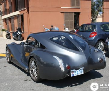

The rear windows of the fabulous Morgan Aeromax started out as just bonded. After a few had popped out at high speed, they recalled them and added mechanical fixings.
