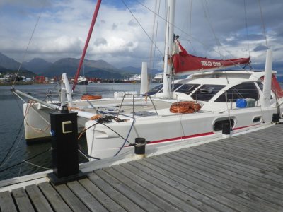

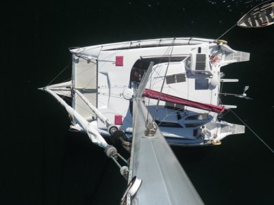

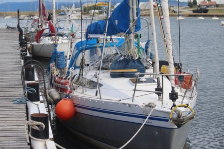

These are 3 yachts plying Patagonian waters. The cat has a decent array on the cockpit roof (and considering they are normally based in Tahiti its almost minimalist). The 2 monos have insignificant solar and they were not alone with their small solar panels (but all, including the cat, had copious ground tackle). All the yachts (excepting the cat) had a decent chimney (the cat may have had a chimney, hidden).
I don't know how many amps each yacht needed - but solar was not a top priority (and I suspect either the engine or a gen set filled the gap
Different priorities, horses for courses.
