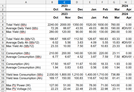

I installed 200 watts of solar at the tail end of last season. Here are my figures over the winter. The panels are vertical east facing while the boat is on the hard.
Interesting to see the performance of solar in the UK. We will be back to that later this year. We run 920w of solar. Yesterday here in Antigua we harvested 4.3kWh from all the panels. That's about as good as it gets for us.

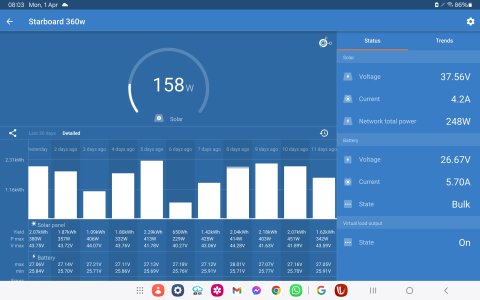

Our best performing panels are the ones we can tilt towards the sun. These are a pair of 180w panels wired in series. Mounted on the guardwires.
You can see from the photos from our Victron MPPT that this week, the maximum output has peaked above the rated 360w a few times.

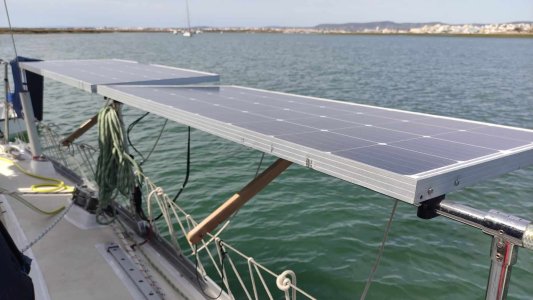

can you post a pic of this setup?

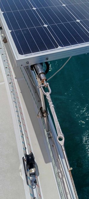

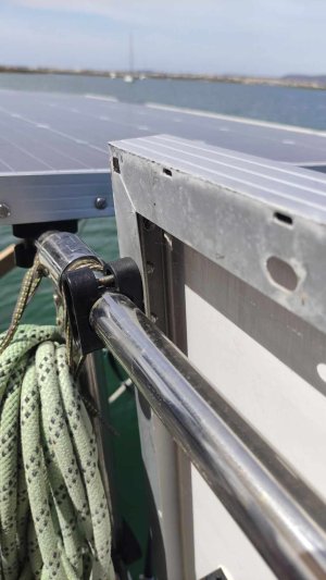

I swapped the last two aluminium stanchions to s/s so I could install a 1" s/s tube. This gives a nice mount for the panels. Plastic clamps rotate on the s/s tube nicely. I installed s/s angle on the panel frame to reinforce the mounting point. Notched timber works great for adjusting the angle of the panels. A couple of bits of string tie down the panels when sailing. At anchor we don't need the string.

This might give you and idea. I used 1” stainless tube and end caps to make solid rails on the quarter secured to the stanchions. The guard wires are still there. Bought from Sheridan Marine.
Canopy Fittings - Sheridan Marine
No doubt there are other ways to achieve the same result.

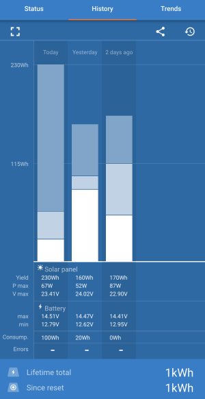

The fridge has been working harder the last 36 hours as it's being cooling down some thermal mass to make it more resilient when it's out of power (I filled the fridge with beer 😁).
However I have upgraded my PWM controller to a MPPT. It gives lots of numbers that I don't understand either 🤪
However it does seem the more load you apply the more the solar can harvest. To me that makes sense lead acid batteries have more resistance when full.
Time will tell, the fridge is wired into the solar controller along with a couple of USB sockets.
That way I can control the voltage they turn off at, leaveing them on and be confident I am not going to come back to a flat battery. I can also monitor the fridge consumption better ( and feel like I am clever than I am 😵‍💫).
As the fridge went onboard when the clocks changed, I figure it might stay till they go back.
Annoyingly the MPPT controller has a setting to turn on the load of a night and turn off of a day, but vice versa.
So I have set the voltage so the battery doesn't fall below 12.6v

That wire was swapped for tube on the last part of the boat so we could fit a panel between each stanchion.
Panels stay in place whilst sailing.
44ft boat.
