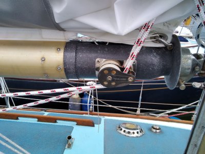

That is the same Proctor boom as I have. This is the tack attachment for my new loose footed mainsail and the turning block for the single line reefing. your sail looks as if it is not cut correctly.
I don't think we can judge that until the tack has been fastened and the sail tensioned as normal.
Yes, I think you can question the cut. First it does not seem full height, second there is no cut back at the tack - see here e-sails.com/measuring/ I posted mine because it is the same boom and style of sail and the foot looks all wrong to me.
I’m not convinced. I can’t see the tack cringle on the photo, which appears to be folded up on the other side out of sight. There might just be enough slack to make it work correctly. I’m not saying that it must be correct, only that the photo doesn’t quite tell us.

You should have a ring at the tack of the sail just like mine and there is an attachment point on the boom just behind the disc that you shackle it to. That is the starting point for setting up the sail. The tack of the sail can't be seen in your photo and the lower part of the luff looks wrong. The cutback start just below where the luff enters the mast track. It is quite a lot because the old roller gear means the attachment of the tack is well back on the boom.
So first thing to do is attach the tack and raise the sail with the halyard as tight as it can go then slack off the topping lift so the boom takes the weight of the sail. If it is cut correctly the boom should clear the panels underneath comfortably. The foot does look short. Was there a reason for that as you lose quite a bit of sail area.
