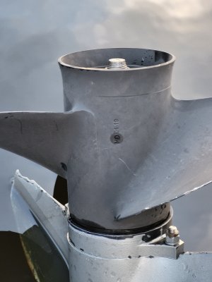

So took it for first good run yesterday, very happy with it, very responsive and got up on plane very easily. I indeed was just tilting it and not trimming the full way.
Only bad part was when my young lady got a little close to land and smacked the prop off a rock!
Is this serious enough for a replacement?
After this she was running at 35Mph at about 5k revs’ and very smooth, but I don't want to run it with the damaged prop' if the engine with get damaged as a result.
If it's not going to directly damage the engine, I'd rather wait to replace in case it happens again, it's a new lake to us so might hit a few things!

Yes, new prop called for.
You may consider having it repaired - normally costs half of a new (£50-ish vs £100).
Did you get any rpm + speed readings? If the prop pitch was a little of, it could be adjusted during repair.
The photo shows the prop hub in way that the prop dimensions stamped in can be seen but not read. You need these to decide if or what change.
If you buy a new I really suggest to go for an original (Quicksilver is the parts brand for Mercury and Mariner)
I think people have been happy with prop repairs from Steeldevelopment.co.uk

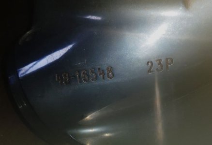

Thanks, still haven't managed to get up there and look at the prop details, I'll get a new one once I do.
I forgot I had two QS stainless steel props at home, the centre peice is missing, which I can probably buy if needed, or take from my current one?
Thoughts?

That 23” will be far too much for her for certain. Will also be for the larger gear case than yours.even if it was a rh prop

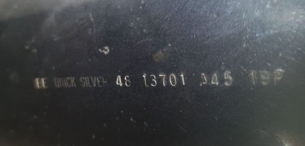

So this is the prop numbers. I've no real idea what I'm looking at.
Anybody know how i might see the pitch? One side says 19 and the other 17...20230505_200915.jpg
Anybody know how i might see the pitch? One side says 19 and the other 17...View attachment 155920
Looks like it’s a 17”. Likely be about spit on for that set up, from what I’m aware around similar boats, engines and gear ratios. Won’t be too far wrong anyway. If she went well enough and within spec, just get another black max 17” suitable for that gear box size. Props listed as suitable will mention a range of something like 75-125hp usually…but not exclusively!
ChromeDome
25 Sep 2020
3,907
The numbers match a Solas Amita aluminium prop, 13.25 inch diameter and 17 inch pitch. The shaft is 15 spline.
Solas is a popular alternative (less expensive) to the OEM Quicksilver brand, but I'd spend the little extra and get one of those.
Your pusher will know the part number - I wouldn't be surprised if it is 48-77344A45 ;)
