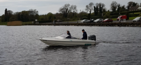

All, I got it in the water yesterday and everything went fine. Moves well, very responsive, revs are down to about 1k, and acerlated very well.
The only issue I had was that the bow is VERY high in the water, about about 3k revs. Like very, there is obv a lot of weight in the back and nothing in the front but I
didn't expect it to be this high. What can I do on this? Keep spare battery and kit in the front?

Well done! Not sure what the bilge is like on a fletcher but was there any water sloshing about in there. Check trim as has been said, is the engine tucking in fully? It should be in a negative trim position fully tucked in.

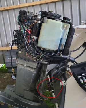

Ok, well I thought it was trimmed all the way down, but it's not negative, in photo above, so perhaps that's the issue.

Yeah that engine does not look all the way down, hard to tell for certain, but that is significantly trimmed out/up imo.

@ The OP…..Does your engine have a trim ram. Are you actually holding the down trim button long enough to actually go to full down trim. Most engine have a two stage tilt and trim. The tilt is quite fast and the trim pushing on the rams slow. This last bit often makes a squeaking noise and sometimes scares people
Two stages indeed.
First trim for use while underway
Then tilt, for use when beaching/putting onto trailer
ok,, my feeling is that I didn't trim it down, as in I didn't wait for that second part, where it trims slowly.
