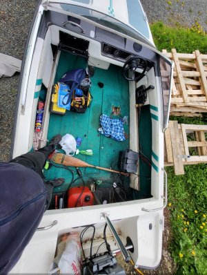

Concentrate on repairing that written floor….Plywood and fibreglass. Keep the carpet it is clasic Fletcher
Yes, this is the plan. I want to get it on the water asap, so just going to put some basic ply and matting on top for now, then when I have time, I'll get marine ply and fibreglass it.
Ive never done this before, so hoping at least the studes to rest the floor on are in place and dont need to be redone. I'll defo be keeping the carpet.
