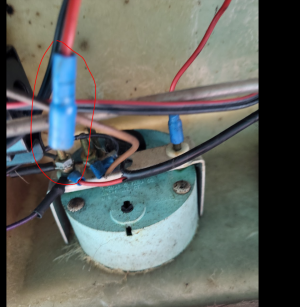

Still ahven't fitted the prop due to time issues, but I wanted to ask a Q about the tachometer.
When I look at the back, there is a wire loose, the red circle, any idea why this is loose or where is should go?

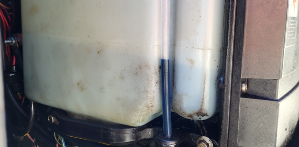

There was a beeping on the alarm from the throttle, had a quick look at said it could be low oil.
This is where the oil level was, would this reg's as low? Anyway, I had a ltr on the boat and I put it in and beeping stopped, so I guess it was.
The oil goes down quicker than expected, I guess the mix is 1-50, but I think this was 1/2 full when I got it and I don’t think I've driven it a lot!

With your normal load the Mariner is to reach the range 4750-5250 rpm at Wide Open Throttle (WOT). Play with the trim and check it if the tacho works - it is the basis for knowing if your prop is right :)
Oil level: Keep the bottle full!
If you suspect it to be defect, a simple solution is to fill both petrol- and oil tank with 4% premixed petrol & oil. That way it will get the oil regardless of taking from one, the other or both tanks

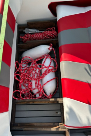

Plan on making back seat storage area, something like this!

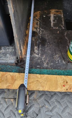

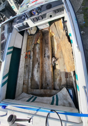

So the floor in the centre had rotted, so I left it for the season with just an extra layer of ply and then some matting.
I'd also put solar power, auto-bilge and some other electric bits and pieces. When I went to go out on it after Xmas (I'd lift the boat in the water)

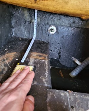

the steering cable broke. So I just decided to gut the boat and start all over again.

Redo floor - I'm going to cut our the old ply, put in some treated ply and I have fiberglass matting & resin to cover whole floor.
I'm not going to leave a storage area in the centre of the floor as it was before, this cause the weakness in the previous one, so I'll just cover.
Undecided if I'm going to put back original carpet or not. While that looks cool. I think it sells easier with new boat decking EVA foam.
New steeling cable and helm - Currently working on this too (see some other posts on getting cable out and right size replacement).
Helm unit was old and stiff anyway, so having a new one will be great for new owner.

Seating and storage - I built a storage unit very like above, which raised the back seat and gave a good bit of storage.
