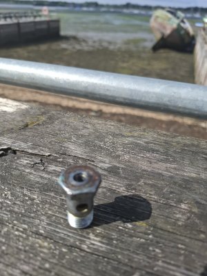

Can anyone please recommend the services of a marine engineer who can help me with a fuel issue I'm having with my volvo penta 2002? All recommendations gratefully received.
I'm also trying to source a replacement banjo nut that attaches to the fuel filter housing and encompasses the return fule pipe (I think!) I have uploaded a picture of the offending item. Does anyone know the part number for this please.
Many thanks for taking the time to read

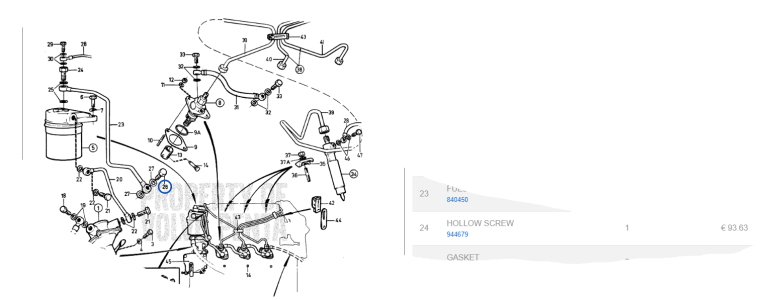

Part number 944679 I think but check on the parts lists at Volvo Penta parts and accessories - MarinePartsEurope.com
The price is ridiculous though. I reckon you'd be able to get one made for less. Maybe a hydraulics parts supplier will be able to match it at a more reasonable price . Otherwise order at VP prices from Volspec Volspec Limited | Volvo Penta Main Dealer | Marine Engineers | Industrial Engineers | Spares, Service or try Golden Arrow marine more locally Home - Golden Arrow Marine
