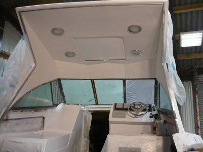

I now use vinyl flooring for interior trim. It is attractive, hardwearing, available from Ebay or your local flooring shop and very reasonably priced. My thinking was if it can be walked on it's going to be OK on the bulkheads.
Also mould is easily removed with Wonder Wipes!
No decent pic' of the heads but here's one of the dog house roof and sides.
I use Saba 750 as the adhesive but any Sika style sealant will do the job. Seriously, have a look!
