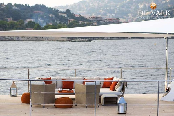

But 1.5y ago, I came across this, and I am seriously considering to use this as a model for a soft top on Blue angel:

the de Valk solution is neat, curious how you're going to secure the poles, need at least two strong points say 400-500mm apart to get decent strength without compromising the integrity and waterproofness of the f/b deck.
also need an easy way to pick it up I guess...
don't like the leopard one, actually don't mind the idea, really hate the rope passing around the frame to secure the tent, weld a flange with holes on the inside and secure it like that and I wouldn't mind at all (probably I'd prefer that to the other solutions tbh!)

So we were looking for a quick solution;
that Feadship example above is cheap and easy todo,
2 fixing poles can be placed in the position of the old antenna’s (Elly would be extremely exited when the antenna’s finally go ;-) )
And two more can easily be fixed on the outside of the FB bulwarks
As in this quick drawing
But then, the Leopard solution seems more solid, and permanent,
I had in mind todo the fabric around the horizontal tube like in this drawing
and know a guy in Fiumicino who can do a perfect job.
but than again, if doing the effort, the grp solution would be the ideal solution,
and I'm turning in that circle now more than 3 years ... :ambivalence:
