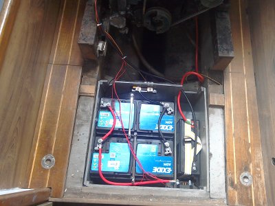

Hi, I am currently refurbishing a Halmatic 30 MkII and having the same ideas. I am replacing the Engine this month and planing to keep the starter battery (taking up less space) under the cockpit sole and move the house batteries under the berth/seat next to chart table to keep the run short (rewiring so I can eventually replace the house batteries with lithium). Unfortunately there isn't an owners association but there are a couple of Facebook pages my preferred is Halmatic/Barbican 30 Owners Group.Hi Halmatic gang!
Mk1 owner here. I'd love to see some photos of your battery setups! Has anyone thought about or successfully relocated the bank from under the cockpit sole? Awesome boat, but its super annoying for engine access. I can only really see the option of removing the whole bank temporarily for workable access to the rear of the engine. I was thinking about under the saloon seat near the heads, but might be a bit too long of a run. Thoughts? TIA
Hi Gadget,Hi, I am currently refurbishing a Halmatic 30 MkII and having the same ideas. I am replacing the Engine this month and planing to keep the starter battery (taking up less space) under the cockpit sole and move the house batteries under the berth/seat next to chart table to keep the run short (rewiring so I can eventually replace the house batteries with lithium). Unfortunately there isn't an owners association but there are a couple of Facebook pages my preferred is Halmatic/Barbican 30 Owners Group.
You are right the engine bay with a comparably large 1980's engine (VP2002 with flywheel) one of the least accessible of any yacht I've sailed on. I am also putting a new Beta 20 later this month or early next - just finishing the prep off this weekend. I reckoned the old engine needed a couple of thousand of pounds of work and there was no guarantee so I've bit the bullet and have bought a new one. There was a little bit of debate on the earlier mentioned Facebook page on the best engine size 20 or 25 Hp (the weight difference is only a few Kgs).Hi Gadget,
I'm actually in the same position where I want to change the engine for a Beta 20 this year. It was actually impossible to remove the rear anode of my old/current engine or change the transmission oil. Tightening the stern gland also required some effort! Without the bank in there seems like you could perch quite nicely to do work. Also I don't know about your boat, but in mine the current setup doesn't allow for the best cable routing either.
I also considered exactly what you're suggesting, having a small starter under the cockpit sole (or even building a support/housing into one of the cockpit lockers could be cool to really keep it open). There might also be space for a small starter under the chart table. The house banks would be inside and be replaced by AGM for now to prevent off gassing.
The only concern I had about where you're suggesting, is that the access for the fuel hose connection is also under here. However, I do feel like that would only need access once in a blue moon. Also, I am worried that where I suggested would be too much of a cable run. Not worried about a change in the weight distribution in these boats either, though that's just an opinion.

The cabling for the house batteries need not be as thick as the starter battery as long as the potential loads, voltage drops etc are correctly calculated. The fuel connections on my boat are not in the same area as yours (they are under the cabin sole).
