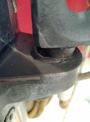

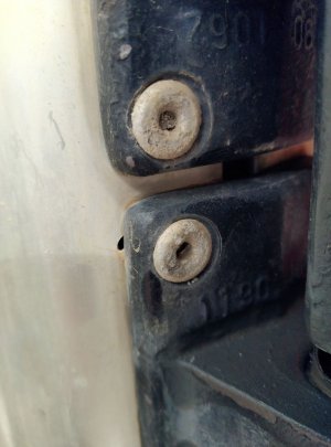

The bottom half of the gooseneck fitting at the mast is worn, needs welding and re-bushing. For that it will have to come off. Drilling out the rivets is no problem but, as the rivet heads are 12mm diameter, I'm pretty sure my hand riveter won't cut it when I come to replace them. Do I buy a HD rivet gun and a handful of large rivets for a one-off job or do I hand it off to a pro?
If I do decide to do it myself, what type of rivets are they?

Thanks. That's what I would use too if I DIY. At present I only have a hand riveter which I've only used once or twice on the boat and I would have to order anything larger as tool availability in Empuriabrava is iffy to say the least. Space is tight and do I need another large tool I am unlikely to use again? The question I really need answering is what size and type of rivet would have a 12mm diameter head?

Have just measured one of the 6mm rivets in my spares box and the head is 12mm. And I understand about too many tools.
Hope that helps.
